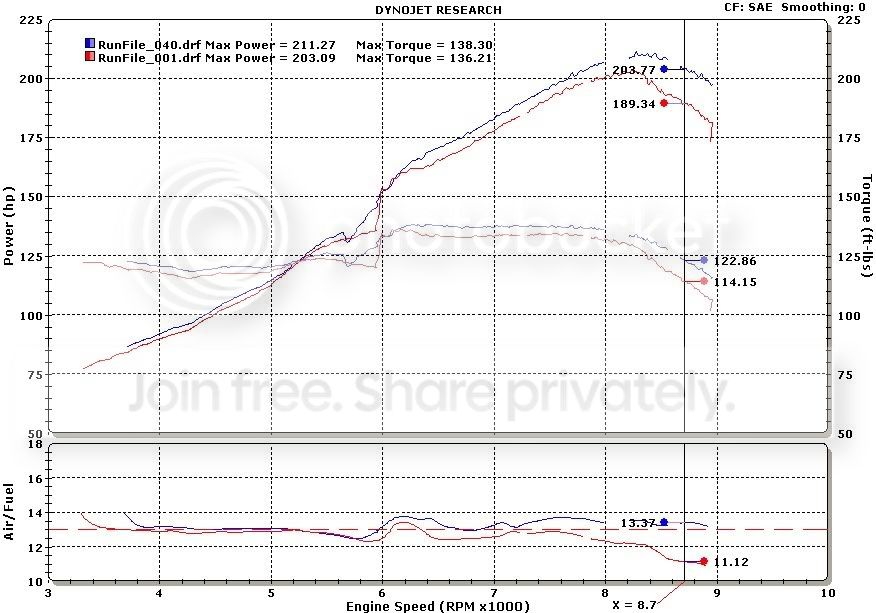

If I were you and wanted CHEAP power, get a VAFC
Ap1's are very easy to fuel tune with a VAFC. early AP1s can get good gains.
here is a dyno of my MY03 tuned by myself. stock vs vafc tune. picked up 8 WHP peak, a healthy 4-5 whp from vtec to peak, and after peak I picked up 14whp.
not bad for only 200 bucks. You also have to consider this is a cheap way to make power, and only for WOT if you want to keep the tune ( partial settings will be relearned by ECU )
also on the dyno just disregard the Dip[ in power before v-tec, that was straightened out.
hope that helps
