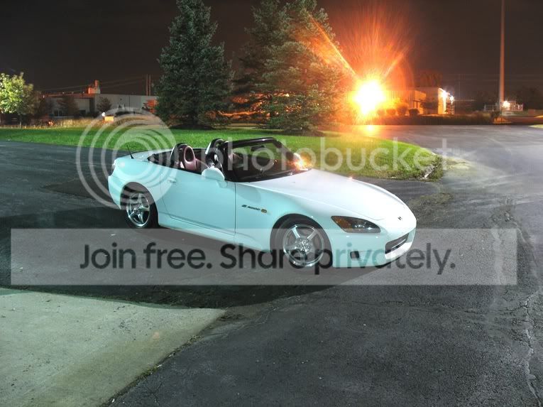

Fronts have .5 finger gap.
Rears have 1.5 finger gap.

weird...
heres my drop. I intalled the same springs on my friend's berlina ap1 and he has the same drop as well...
