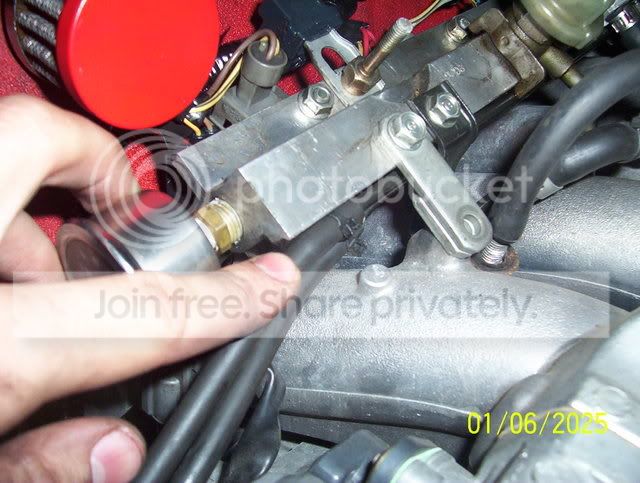

I pulled off my turbo and I have these two rubber hoses that come from under the
fuel rail and lead to this plastic unit thing lol. I'm trying to figure if that is for my
turbo or if it's stock and they mounted it in another spot. Let me know what I need to do to clean this shiznit up. Thanks!

Vacuum hoses for your secondary air pump. Not needed unless you're trying to pass emissions.

so just pull the hoses off at the end by the fuel rail? Won't that give me a vacuum leak?
What about the sensor like piece? IS ALL of that aftermarket or what?

<TABLE WIDTH="90%" CELLSPACING=0 CELLPADDING=0 ALIGN=CENTER><TR><TD>Quote, originally posted by boostedEBP &raquo;</TD></TR><TR><TD CLASS="quote">so just pull the hoses off at the end by the fuel rail? Won't that give me a vacuum leak?
What about the sensor like piece? IS ALL of that aftermarket or what?</TD></TR></TABLE>
Remove the secondary air pump. You'll throw a CEL if you're still using the OEM ECU.

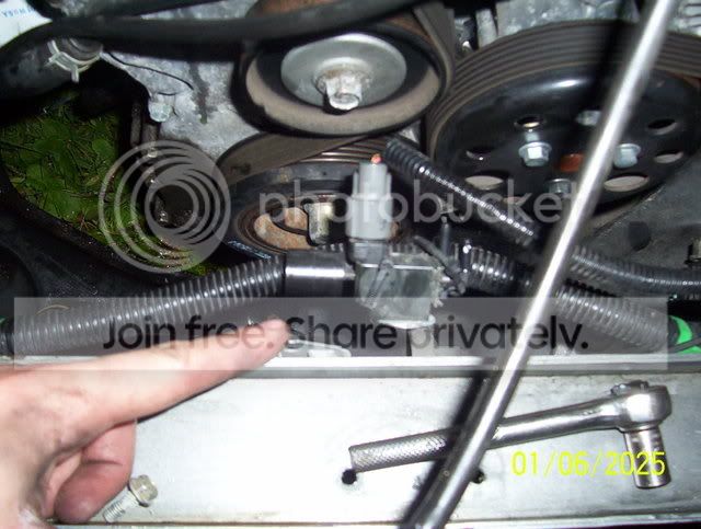

oh and that plug i nthe second picture of mine... was that used for the turbo?

<TABLE WIDTH="90%" CELLSPACING=0 CELLPADDING=0 ALIGN=CENTER><TR><TD>Quote, originally posted by boostedEBP &raquo;</TD></TR><TR><TD CLASS="quote">oh and that plug i nthe second picture of mine... was that used for the turbo?</TD></TR></TABLE>
No, has nothing to do with the turbo.

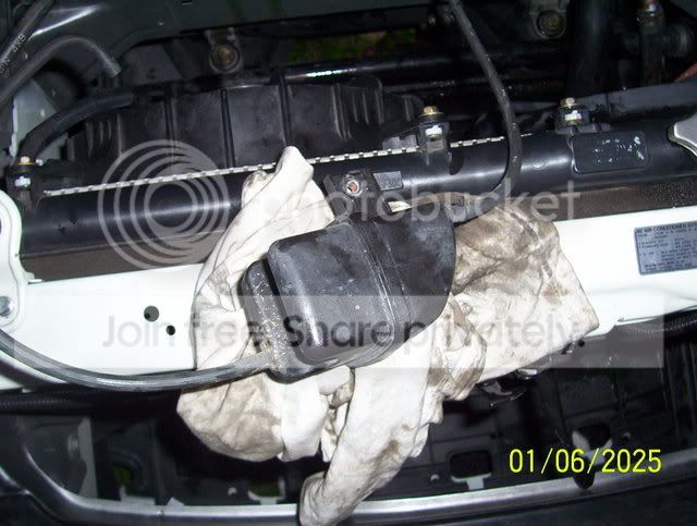

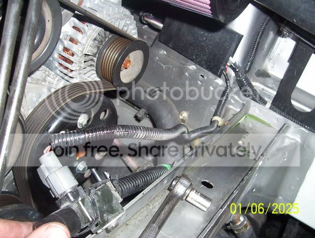

Oh I think that is already removed. I get a code that if I remember correctly says... Seconday Air Injection. I'm just trying to figure out still what that black box looking thing is. I am N/A now... the turbo was removed and I am now running on my stock ECU.
So that plug that is running to that other black box that is mounted on the frame, that stays since I am N/A right? I guess I am confused cause these look like factory plugs (2 of them) that lead to that black piece that I am holding in my hand in the last pic. Doesn't look like those should be removed...

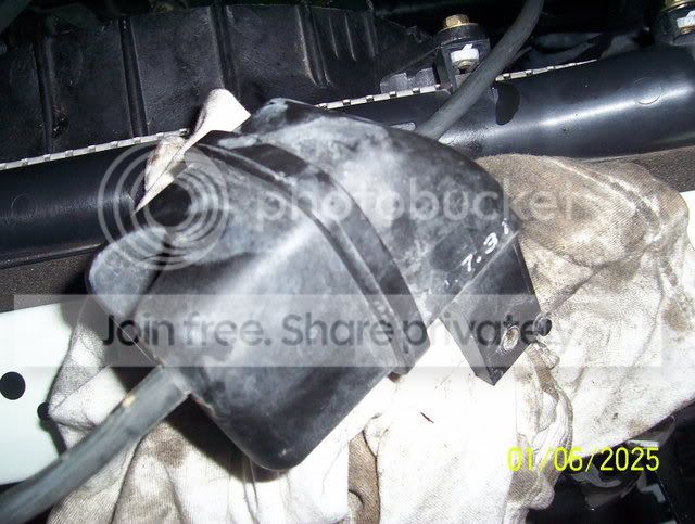

Do not remove the thing you are holding in the last picture. I don't know exactly what it is, but it has to do with the secondary air pump. One of the two hoses that you removed (the ones that come from under the fuel rail) connects to that black box that you're holding. You see the little thing that's protruding out next to the plug. The hose goes there.
If you're not turbo charged anymore, you should reinstall the secondary air pump as it's needed to pass emissions and to eliminate that CEL.

Yea I got two protuding black pieces where the hose would go over and one hose from under the fuel rail leads to one, and another hose leads into the other hole that is coming from the black plastic box looking thing in the second to last pic. I have 2 hoses coming out from under the fuel rail.
You also tell me to keep that the black plastic piece, in the second to last pic... the only thing is that one of the lines that are under the fuel rail lead to that box. Then from that box leads into one of the holes on the plug in my last pic. I understand to remove the metal rails that are under the fuel rail after i took a closer look at your pictures, but I would like to know what that black box is, and wher it is on YOUR car or where the factory location is. I guess its just frusturating cause I have been checking out other S's and don't see lines where I have lines/hoses and its kind of pissing me off lol. Oh, and is the location for my secondary air pump right behind my front bumper on the passanger side? Thanks for all the help bro
