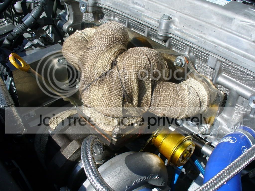

Default Re: header wrapped or not? (dcturbols)
holy cr*p nailed it on the first try...
it dose look dam cool
little trick i picked up... you see any ties

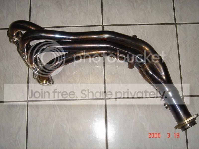

Default Re: header wrapped or not? (fridaytech)
That's not an S2000 header.
I see a possible problem spot where the primaries join into the secondaries, with the extra wraps around that area. Maybe.
