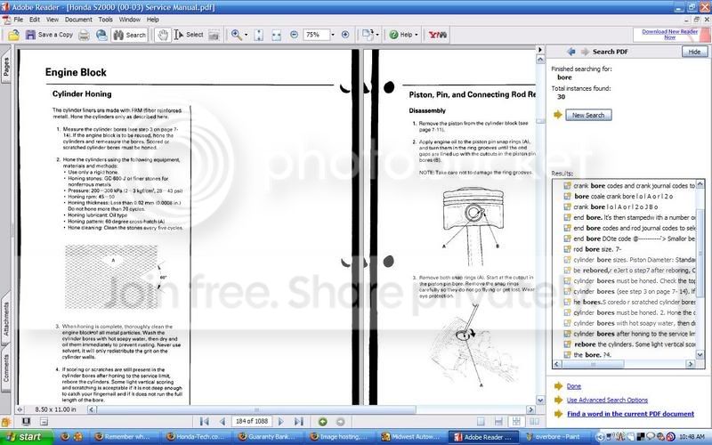

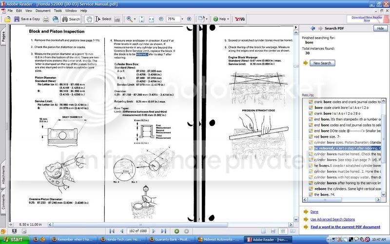

Default Re: engine bore (chino2x2x2x)
Old Oct 23, 2007 | 04:42 PM
chino2x2x2x's Avatar
Joined: Jun 2007
Posts: 52
Default Re: engine bore (MidwestAutoWorks)
where can i get a copy of that file
Old Oct 23, 2007 | 05:27 PM
MidwestAutoWorks's Avatar
Posts: 5,784
From: Midwest, WI
hondahookup.com
