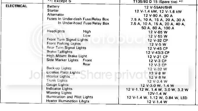

11.8 volts is low you should be at 12.45 at the lowest which is 75% charged. 14.0 volts running is about right. If you work at a shop you could do a load test on the battery using a VAT which would tell you if the battery is bad or not for sure.

12v is a full charge on a battery, and 11.8v is completely normal in my experience.
the 14v is from the alternator running.

no buddy, 12v is not a full charge, full charge is 12.6v. 12.0v is like 25% charge. i know it sounds crazy but its true.

you can buy some other battery that charges to 12.6v if you like, the battery manufacturers are pretty lax with their standards. but honda spec is 12v. everything on the car is 12v, with the exception of the interior lights which are regulated to 5v

here i found something on wikipedia
http://en.wikipedia.org/wiki/Car_battery
12.65 V 100%
12.45 V 75%
12.24 V 50%
12.06 V 25%
11.89 V 0%
