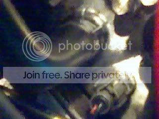

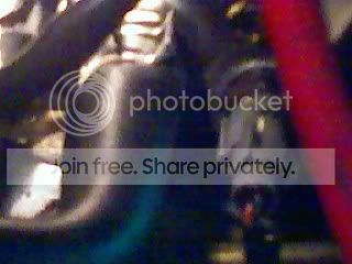

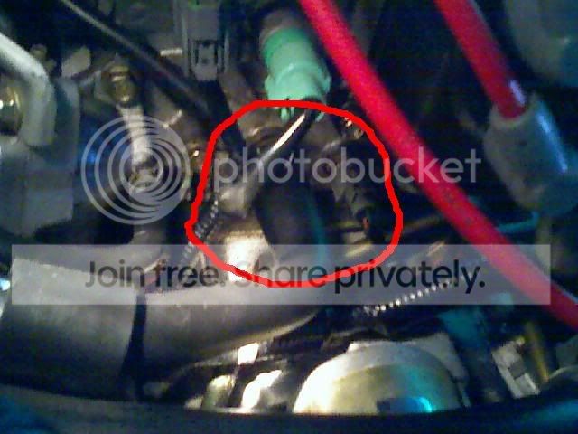

hey guys, i was doing my usual routine checkup and notice something underneath the dizzy and removed my intake and thought i'd take pic's and found oil build up which some of it was old and fresh i'd like to know what this that i circled? it did cause it to leak down under to the ground and im not sure what to do, thanks guys...

for some reason the first image didn't show where i circled..

well, the big hose is your heater core hose.. the plug is either a fan switch or coolant temp switch(i forget which one is which)
your oil leak is most likely the distributor o-ring, as the two things in your circle only deal with coolant..

the solenoid is directly above the red circle on your first picture. There are two plugs going to it, one has a green/yellow wire, the other has baby blue and black wires.
