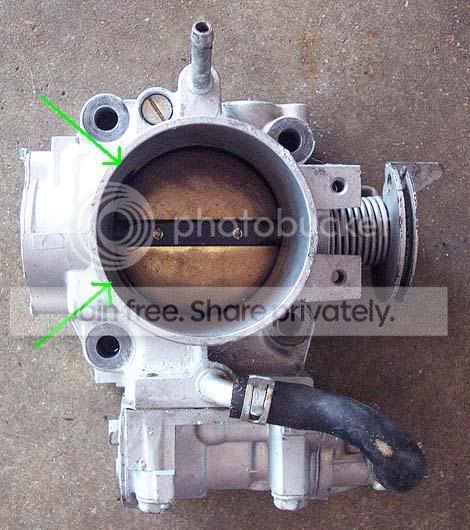

I'm talking about the holes in the throttle body, connected to the intake.
If you were to take your cai, or oem intake, off, and were looking directly into the tb, you'll see the two holes on the left side of the tb. You guys have an idea right?
Anyways, the lower left port is constantly pulling vacuum, even at idle, 800rpm (NO surge).
I've already switched the iacv, and I'm still pulling vacuum like hell.....
Is this normal??

Thanks to Matt, for the pics.

If your idle is good (and it sounds like it is) then I wouldn't worry about it.

Any vaccum leaks?
Thats the FITV hole

No, sorry. That's not how it works, and if it did, you are saying that you have too much air? That would not use more fuel... Unless you are saying it's sucking in too much air and then compensating by adding more fuel, which would mean the rpms would be much higher.
If your car is getting too much air at idle it's going to rev higher...no way around it. At certain rpms with a certain engine, the engine only moves so much air, you can't change that with holes on the throttle body.
What happens when you plug the hole you think is sucking in too much air?
How are you calculating your MPG?

i've had an intake whistle before, and, somehow, backing out the idle screw (adjusting idle up) took care of it. Not sure if that's kosher or not
Old May 30, 2008 | 07:18 AM
prelude_h22vtec's Avatar
Posts: 933
From: raleigh, nc, usa
yeah i think one of those holes if for the idle bypass, which is adjusted by the screw on top. the other hole is for the FITV, controls the cold idle. i would say dont worry about it unless your idle is ridiculous. its pretty normal. mine sounds more like an f22 than an f18 though, but the intake makes some nice sucking noises at idle. if you really wanna get rid of the sound, tighten up the screw up top.

If I turn the ia screw down, it slows the engine to almost 175-200rpm, where she shakes and shutters, almost to cut off, and the vacuum stops from the fitv hole.
With the car warmed up, the lower port is still pulling vacuum, which indicates a bad fitv, or leakage through the fitv, right?
I've already taken the fitv off and tighted the plastic disk....It's super tight.
The weird part is, when I plug that lower hole, when the engine is running, and warm, it's still pulling a small amount of air, just enough for a slight vacuum.
This port, (for the fitv) or hole, should not pull any air unless the engine is warming up, or unless I hit the throttle.....Correct?
I'm thinking of just bypassing the damn thing.....The fitv that is. I'm going to check the faqs now......
