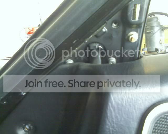

In the process of replacing my passenger side mirror. Not as easy as i thought. I can't get to the two lower screws and that panel covering them does not budge one bit. Is there anyway of doing this without taking my entire door apart?

looks like you need to take off your door panel - search the prelude archives (door panel) to get the screw locations for removing it.

Its really easy to take the door panel off dude

yup its easy... just two or three screws and the rest is snap off...

theres ascrew at the door handle and a clip to remove the arm. a screw at the front probably plastic. a screw in the arm rest. pry out the window door lock switch (carefully) unclip the harness. star at the bottom with a wide flat head and pop the panel of and raise it off the window guide. ur done!
