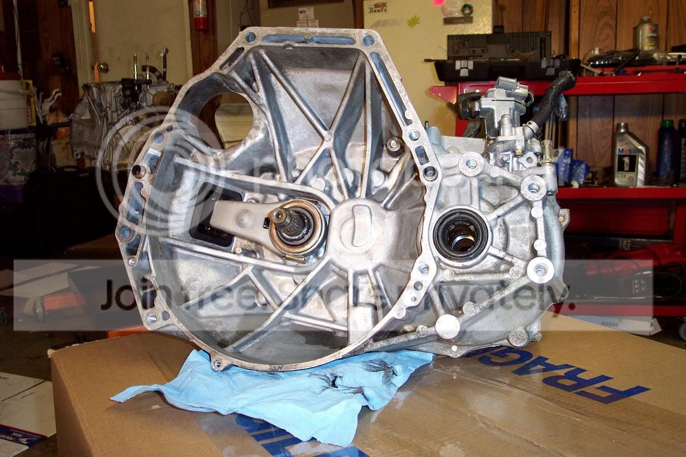

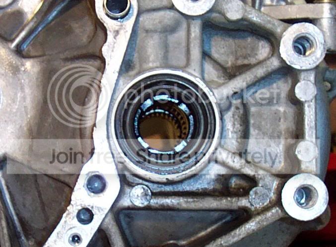

can you tell by these pics if its the jdm lsd?

yep its lsd, no counter shaft. check the code , should be m2b4

<TABLE WIDTH="90%" CELLSPACING=0 CELLPADDING=0 ALIGN=CENTER><TR><TD>Quote, originally posted by SteveoBA8 &raquo;</TD></TR><TR><TD CLASS="quote">yep its lsd, no counter shaft. check the code , should be m2b4</TD></TR></TABLE>
youre right...except just a nit picky little terminology....the bar that you would see through there is a shaft between the spider gears, not the countershaft....but that is an lsd diff...

whats all that stuff on the top right of the tranny in the first pic?

<TABLE WIDTH="90%" CELLSPACING=0 CELLPADDING=0 ALIGN=CENTER><TR><TD>Quote, originally posted by AzCivic1.6 &raquo;</TD></TR><TR><TD CLASS="quote">whats all that stuff on the top right of the tranny in the first pic?</TD></TR></TABLE> vehice speed sensor and those rubber lines are powersteering, 4th gens have variable assist power steering

aahh i see. thanks.
