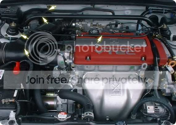

This has nothing to do with your question: I was just going to say to look at the intake manifold to make sure it's a real Type S engine, which does not have an IAB system in the intake manifold. I believe there also isn't a PGM-FI emblem on the Type S intake manifold. I saw a regular H22 on eBay today with a Type S valve cover, being called a "Type S" and with a selling price of $4,000. I feel sorry for the uninformed person who buys that.

I thought I read the Type-S had IAB's and Euro-R's didn't. Also, the picture of the Type-S engine on hmotorsonline.com shows PGM-FI on the IM I believe. I could be wrong about both though.

To compensate for my retardedness here is proof that I am wrong and you are right. The Type S has IAB's, this is a real Type S, you can tell from the oem strut bar and intake tube.
