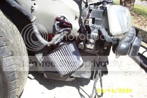

That's where the AEM CAI filter sits on a 4th gen. Pretty high up if you ask me. You'd have to go thru a VERY deep puddle to completely submerge that thing.

what people dont get is you dont have to SUBMERGE the intake to get water in your engine. if you fly thru a 3-4 in deep puddle you will throw enough water on the filter to get some sucked into the engine. make sure you have the inner fender well/splash guard. it does wonders. + the bypass valve is what i use.

if you get a ebay intake, make sure the filter is decent. I bought one and the tip of the cone was done wire mesh. No way it was stoping dirt. The pipe works great, just get a good filter.
