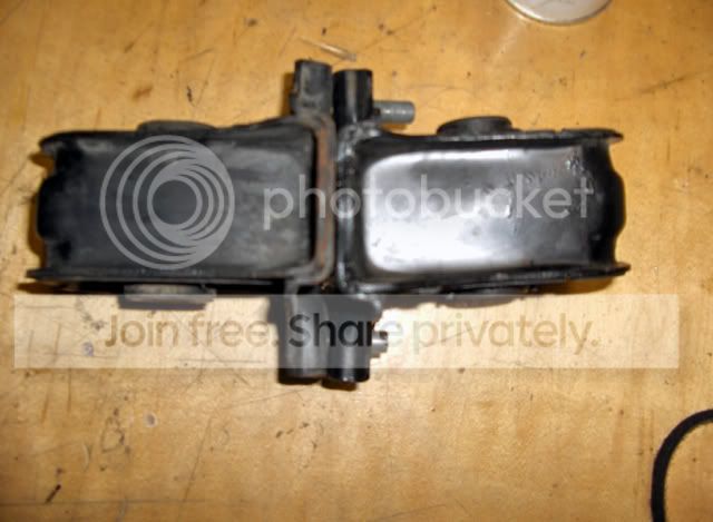

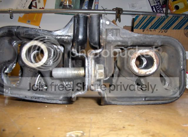

Ok, here is the comparo.
And explain to me why this dosent line up.

the front mount may appear to be different, but will not be....why would honda move the motor's location between automatic and manual models....
your pics are so huge and close up its hard to get the big picture, but ill try my best here....
i think it just ends up being the same, maybe the bolt holes are offset because the metal is the opposite offset, and net the same position...are you very sure that both of those are from a 5g prelude??

Im positive they are both out of 5th gens as I saw the car the AT mount came out of. The mount will bolt up but it will be offset to the pass side so the rubber stopper would be at an angle if I mounted it.

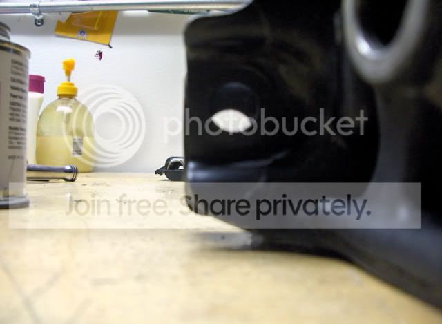

the second picture of the left engine mount looks as if it's been physically reshaped. did the car it came off of get in an accident?

<TABLE WIDTH="90%" CELLSPACING=0 CELLPADDING=0 ALIGN=CENTER><TR><TD>Quote, originally posted by khalal538 &raquo;</TD></TR><TR><TD CLASS="quote">the second picture of the left engine mount looks as if it's been physically reshaped. did the car it came off of get in an accident?</TD></TR></TABLE>
It was hit, but it didint bend the crossmenber. Got my new mount yesterday and now its all buttoned up.
