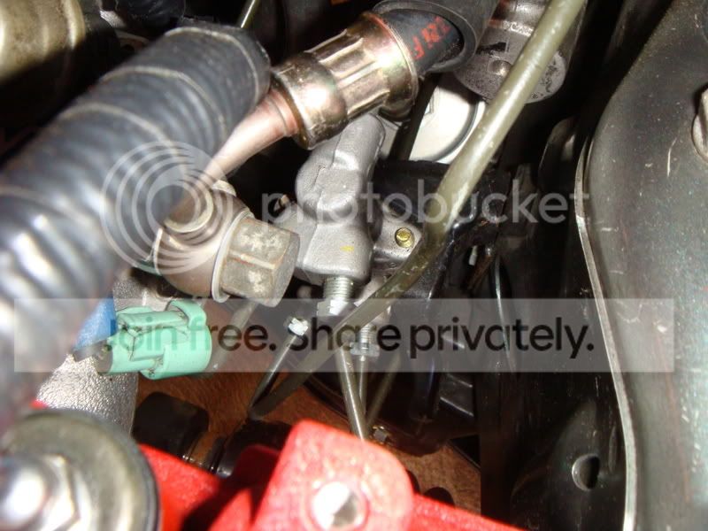

<TABLE WIDTH="90%" CELLSPACING=0 CELLPADDING=0 ALIGN=CENTER><TR><TD>Quote, originally posted by lude98SH &raquo;</TD></TR><TR><TD CLASS="quote">I did mine last summer. </TD></TR></TABLE>
I forgot about that! Any pics?

not now ill take some this weekend.

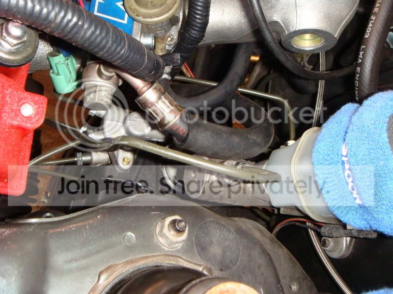

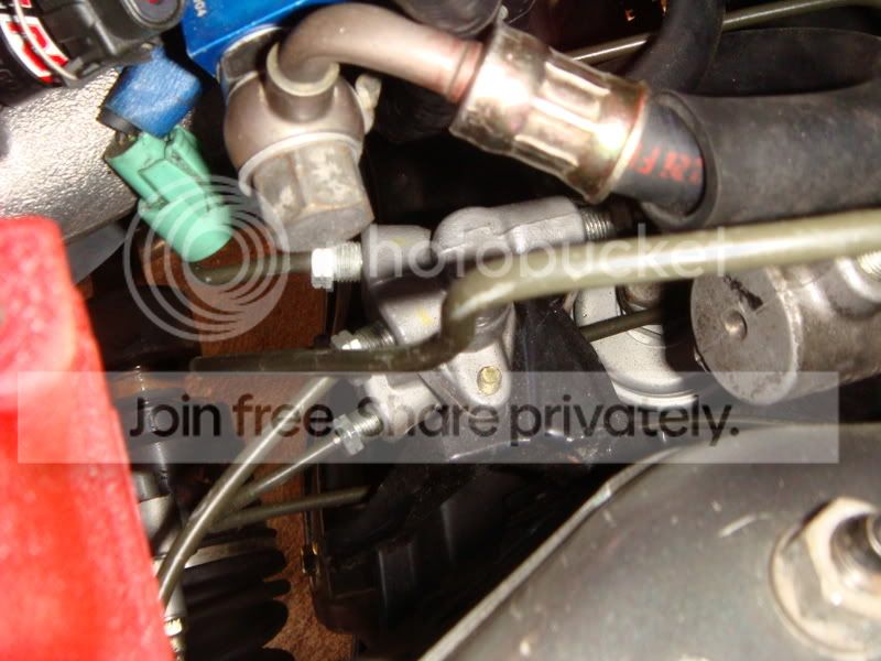

what i had to do was get a bracket welded to the proportioning valve oem bracket and drill holes for the bolts in it so i could bolt it in the stock location.

Default Re: eliminating the abs (Hawkze_2.3)
<TABLE WIDTH="90%" CELLSPACING=0 CELLPADDING=0 ALIGN=CENTER><TR><TD>Quote, originally posted by Hawkze_2.3 &raquo;</TD></TR><TR><TD CLASS="quote">
It could certainly be done, but it would be expensive and brake feel would probably suck with any SS line over 12" or so...
I forgot about that! Any pics?</TD></TR></TABLE>

Default Re: eliminating the abs (lude98SH)
Good pics lude98SH, hopefully that will help some people
no problem. I could have taken more but i wasnt sure what else would be beneficial.
