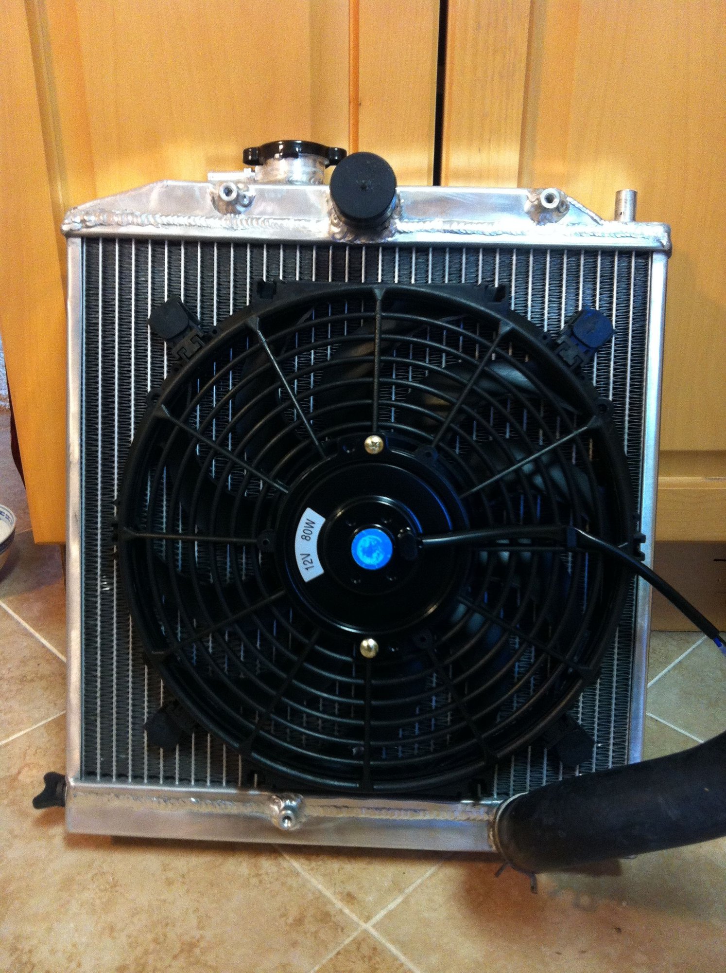

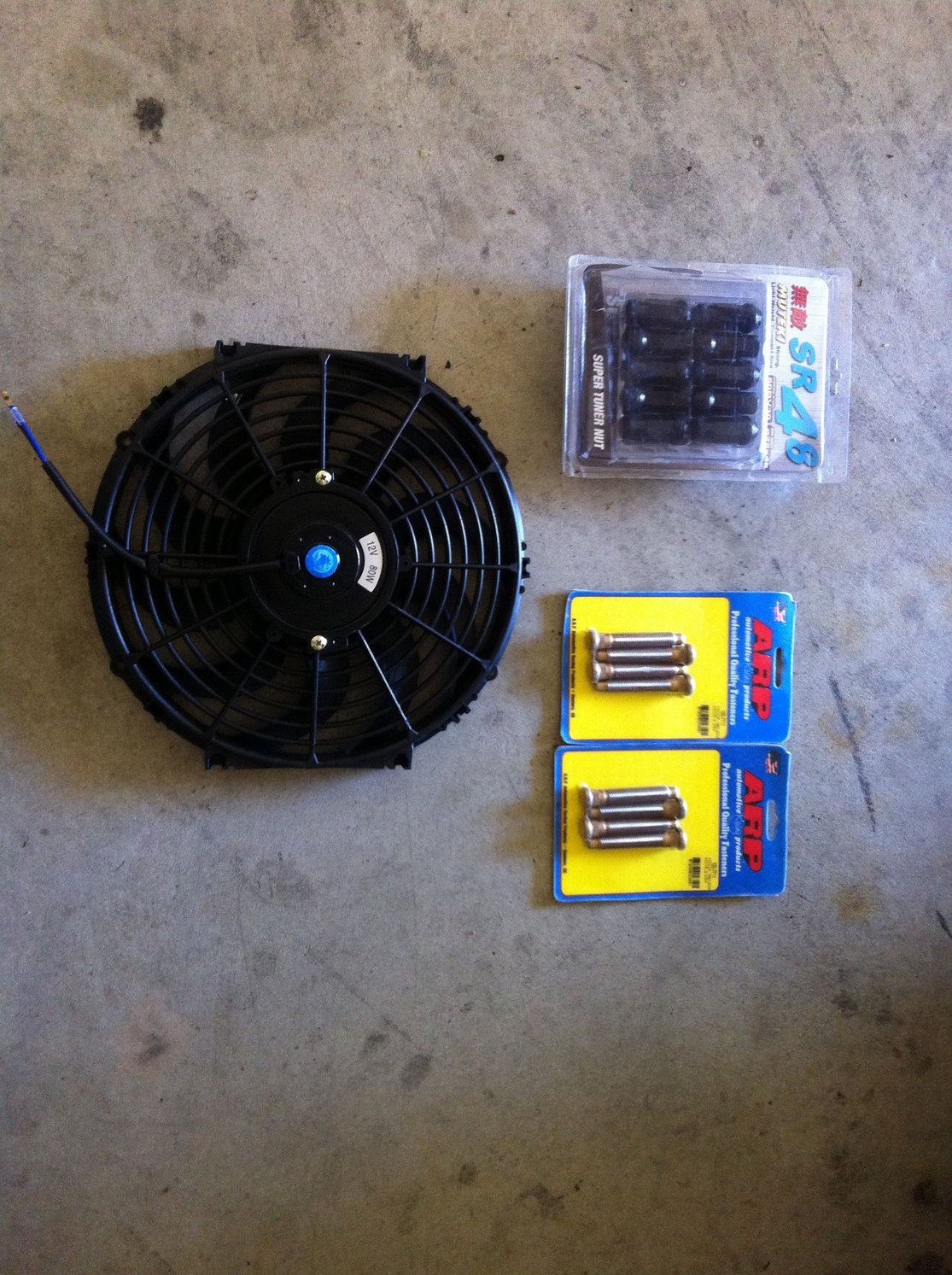

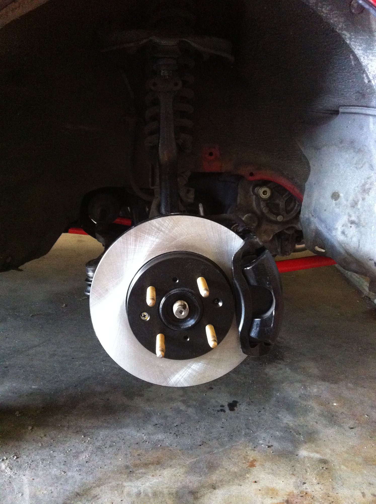

Little update: more parts came today, prepped the EX spindle, hopefully install this week. Any recommendations for slicks sizing? Keep in mind with the brake upgrade, I don't think 13s will fit. Thanks.
12 in slim puller fan, ARP extended studs (required for slicks) and open ended lug nuts.
Prepped, cleaned, lubed, ready for new bearings, rotors, and pads.

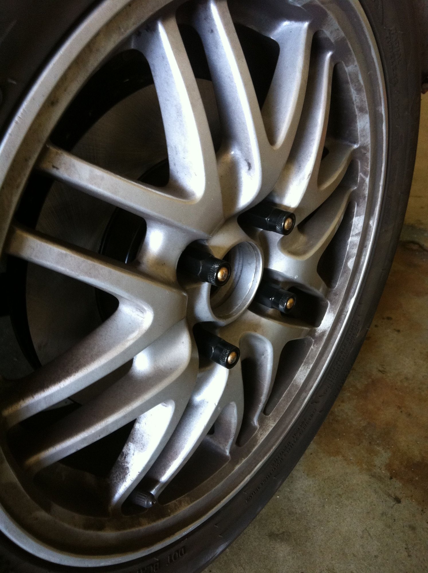

UPDATE: Got the EX spindle all done. Car rolls freely now, thank God! Enjoy the pics.
Quick trip to the dealership. HONDA approved!
Slim fan installed.
So fresh and so clean.
This should solve my axle binding problem.
Bye dinky DX brakes, you served me well.
Hello big boy!
I need new wheels.
Lug nut fits extended studs just right.

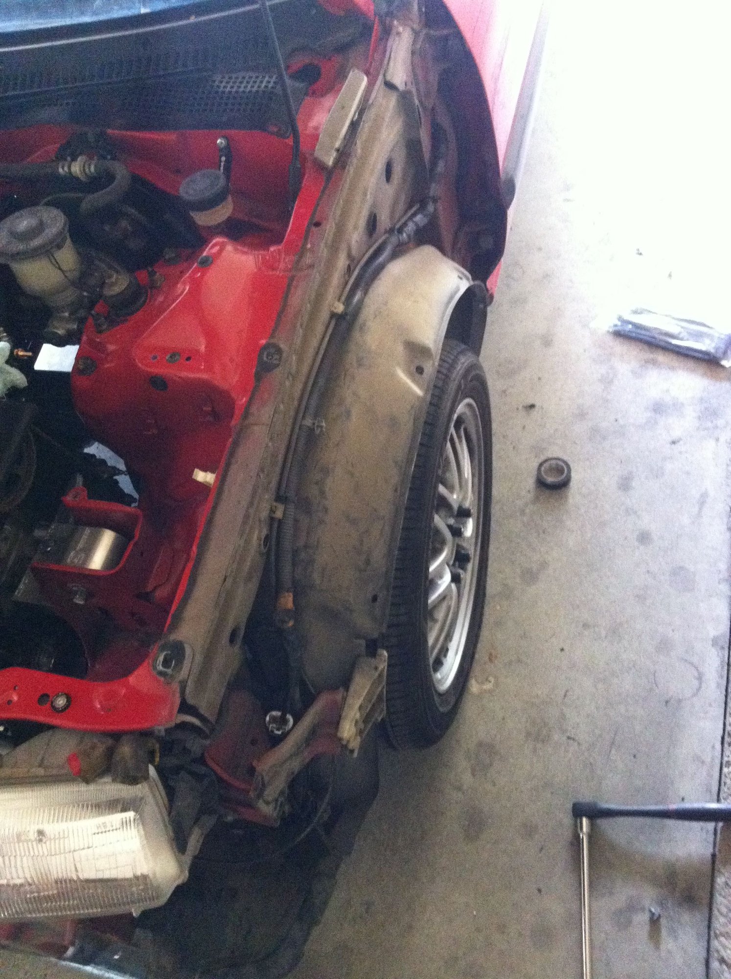

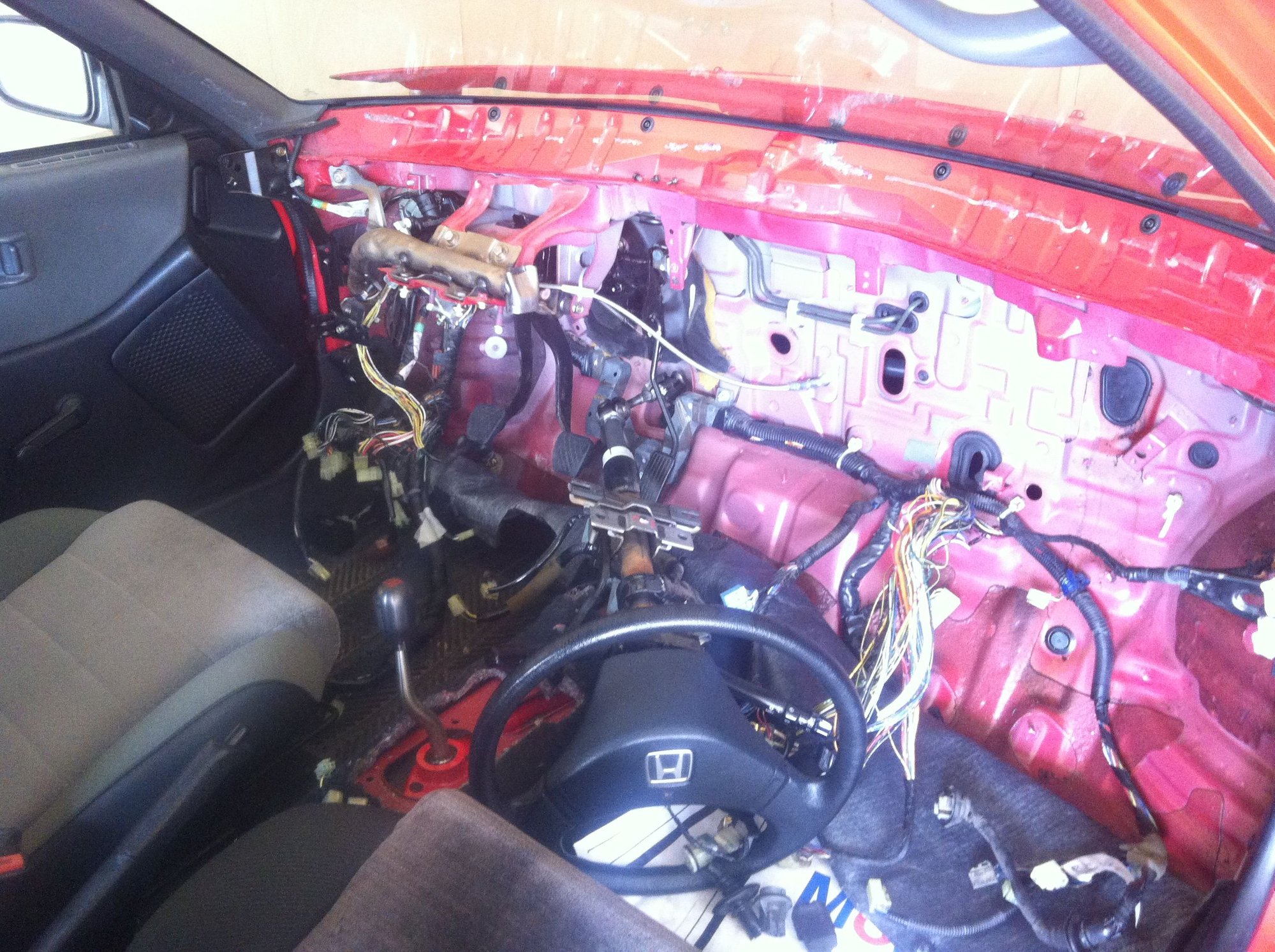

Update: Bored waiting for ChaseBay, so I tucked the entire bay, free of any wiring as of right now.
RF tucked
LF tucked
Nice and neat
Messy, what have I done?
That's better.
Main harness. Everything not used will be de-pinned.
HURRY UP CHASE!!!!

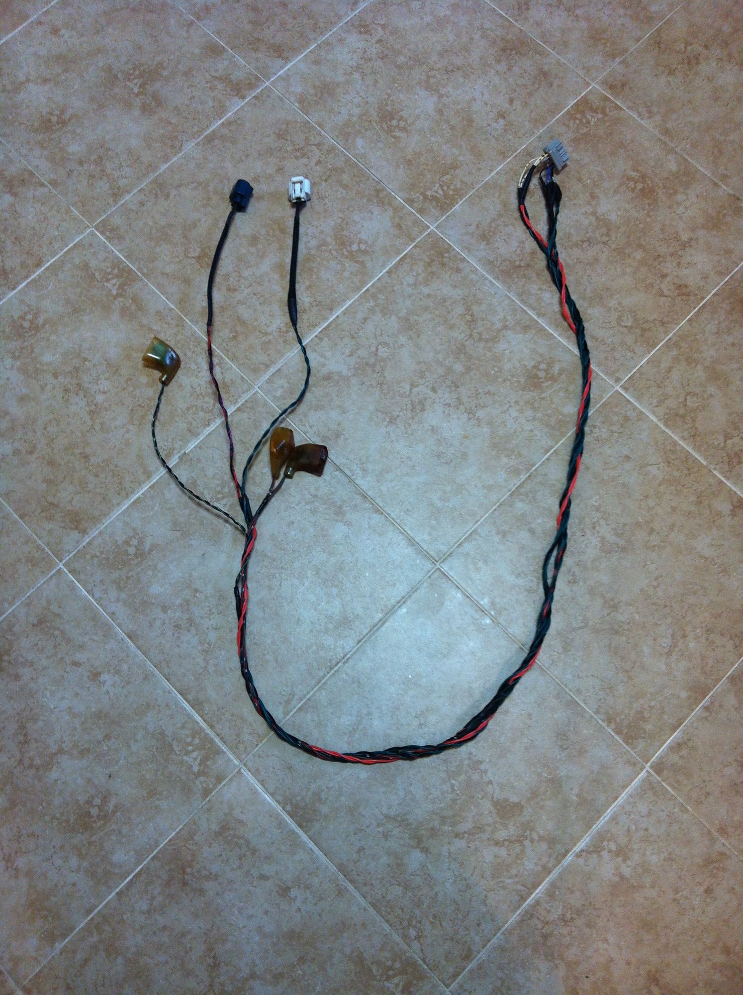

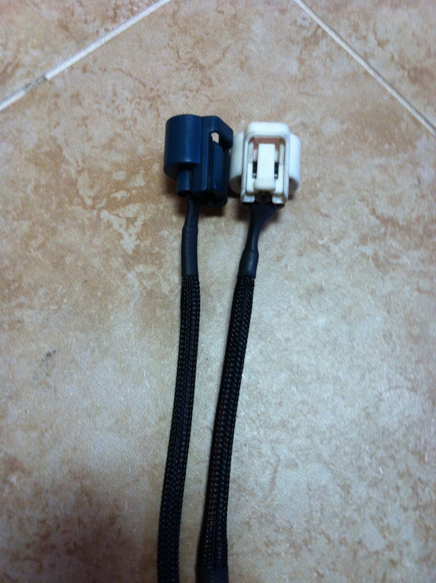

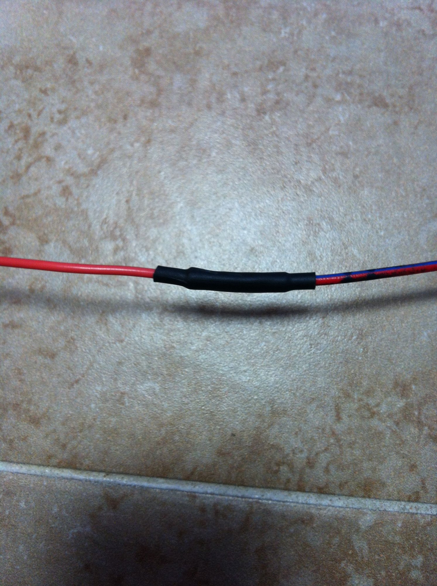

Since I had to extend the RF wires to reach the lights, I decided to make a sub-harness for each side of the fenders. These wires originally were a part of the main harness, and it got quite messy. With the new sub-harness, I could use the OEM grommet to protect the wires passing through the frame to the fender and I can quickly disconnect each side for easy service. Every connections were crimped, heat shrunk, and use OEM pins and connections.
See pictures, any comments or questions happily welcome. RF done, LF next. It takes A LOT of time to make each connections, twisted each strand, and labeling which goes where. Here is the final product.
Each connector cleaned, and the strands twisted for a clean look.
Where I extended the wires, I crimped, pulled to test the strength of the connections, then heat shrunk.
Then I connected each wires to OEM pins.
Example of one harness within the sub-harness. In the case, this is the bumper light wiring.
Here is the corner light connections.
Since the headlight connections will be visible, a little extra addition to please the eyes.
Completed RF sub-harness. This will plug into the main harness.

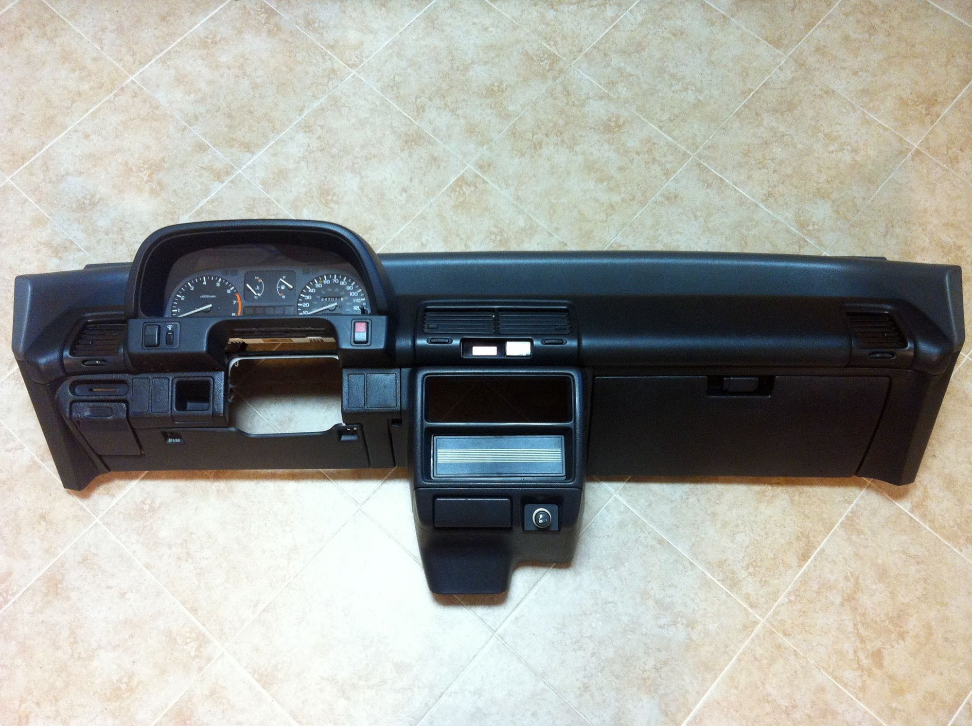

Seriously JHPUSA, I ordered ONE piece and you got it wrong. Hope this will be fixed soon so I can complete my fuel setup. Still waiting on ChaseBay so I cleaned my dash; maybe I'm biased but old school Honda dash looks a million times better than newer generation Hondas with all the new gadgets and doodads (my daily is a 2016 Accord Sport). I LOVE LOVE LOVE the simple, clean look of the EF Civic dash. I was lucky with this one, not a scratch or crack. It is gutted underneath, but still retain the OEM look. I'm contemplating whether or not to put the heater controls back in and put the gauges where the radio delete plate is, or get a carbon fiber plate to fill the heater control and mount the gauges there. Opinion? Any recommendations for gauges? Brands?
What I ordered
What I received
Old school HONDA=LOVE

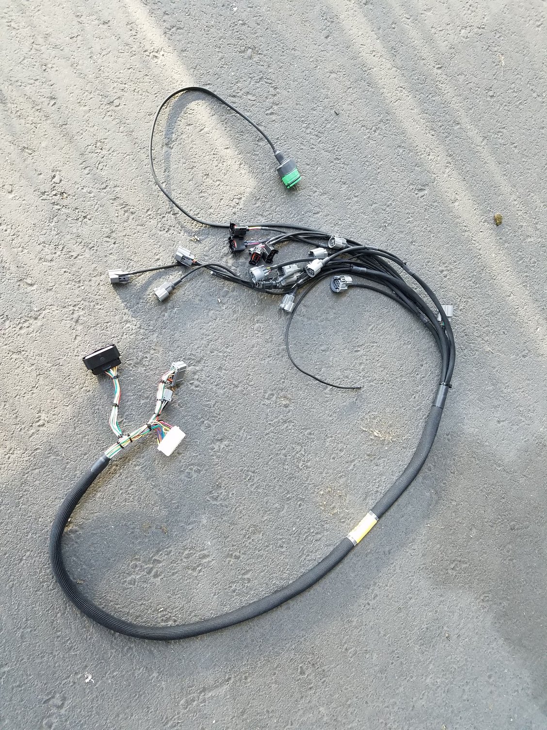

Holy hell, after 5 months of waiting, my Chasebay harness finally came. Jeremy at Redzone came through with the s300. All that's left before I fire her up for the first time in the 3 yr long build is this final harness install. Please refer to pictures as I have a few questions. Thanks guys.
I should have paid extra to have the plugs labeled. This will not be fun.
Question, where does that white connector plug into? Those 2 loose pins on top? And there are 5 wires that needs to be spliced into what? No instructions came of course. FML.

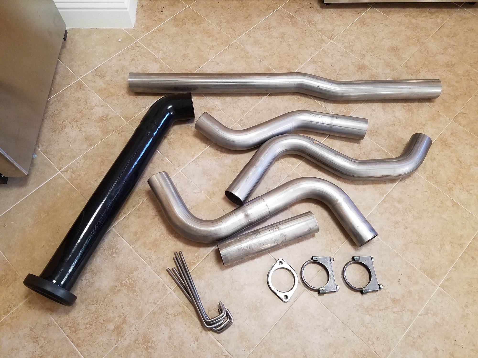

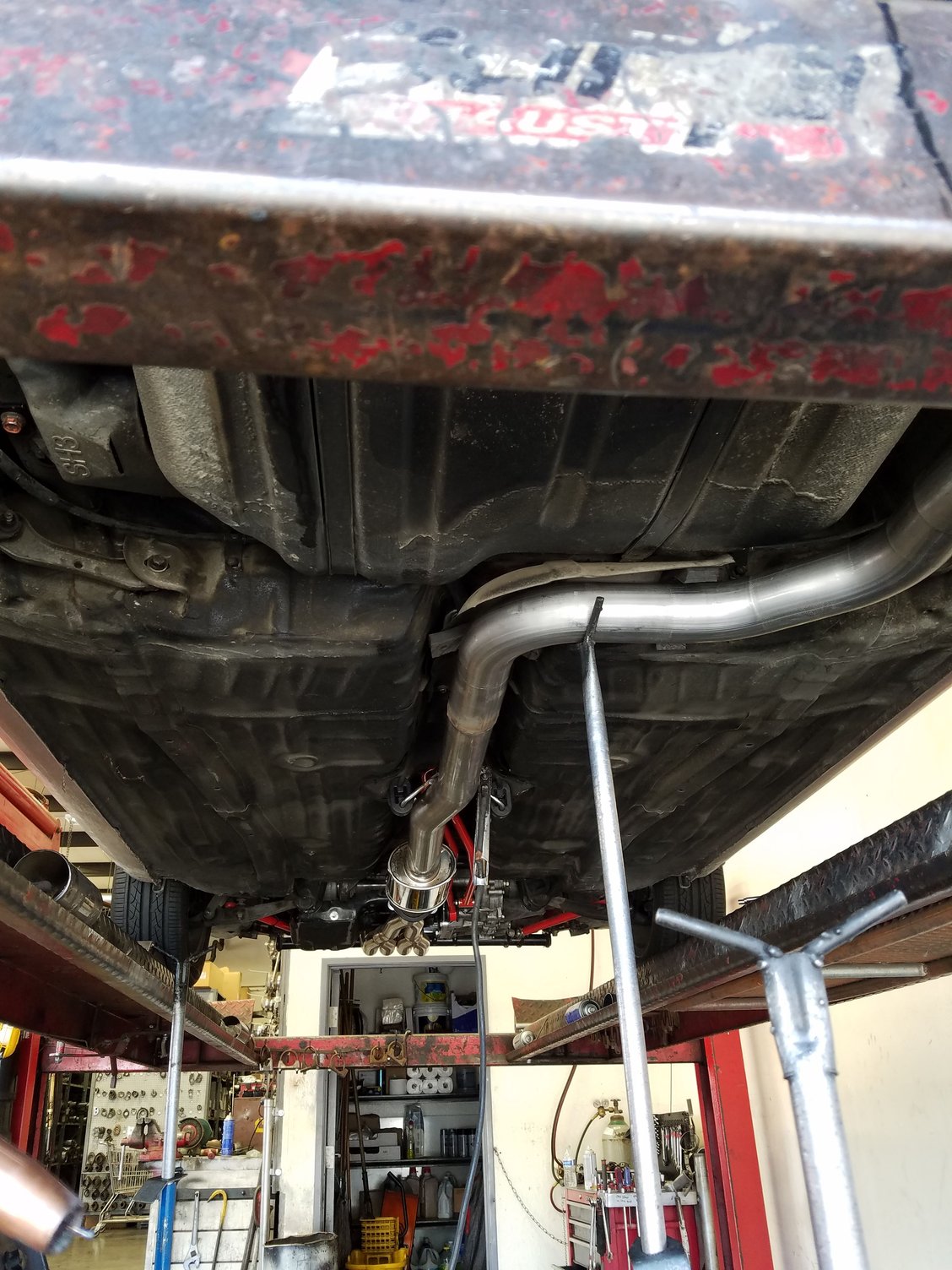

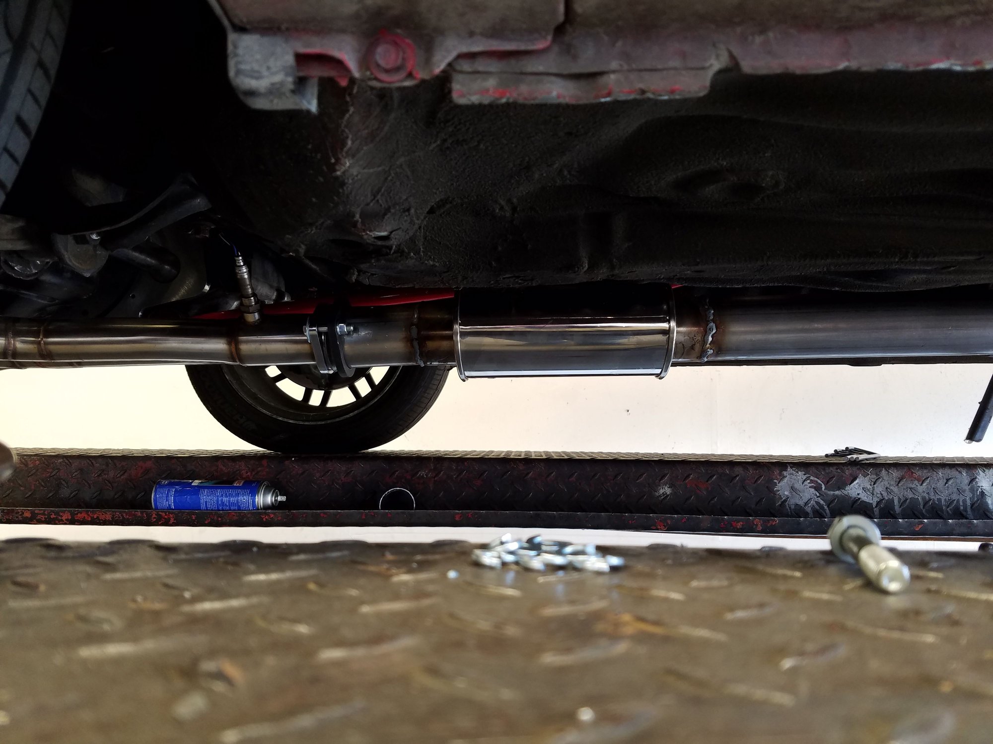

3" stainless steel, mandrel bent KTeller exhaust with Vibrant ultra quiet resonator and universal flat black muffler.
Update: exhaust parts came in along with new intake setup. I'll be having the exhaust welded on tomorrow and off to the dyno as soon as I get an appointment. Track nights every Wednesday, so I'll be excited to see what it'll run. I wanna get a baseline before building the motor and suspension.
3 inch stainless steel, mandrel bend EF kit from KTeller. 3.5 silicon tubing with Vstack.

Exhaust done.
