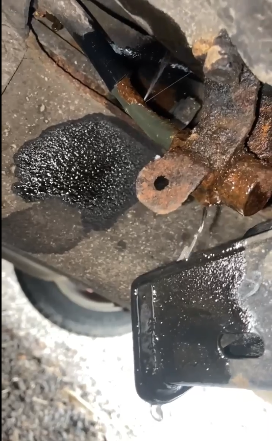

Hello,
I have a bit of a messy situation, I have a few rusted fuel lines, where as one of them are leaking pretty bad. I'm not quite sure which line this is, but its an 8mm hardline. What would the easiest fix for this be? And what kind of line is this, is it the return?
Thanks,
Chrsb

It's the fuel feed line that gets pressurized.
If you do find a used line to replace it with, the round 90deg connector is different thread size I heard from the '88 vs '89-91..
