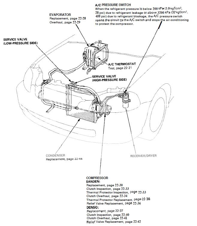

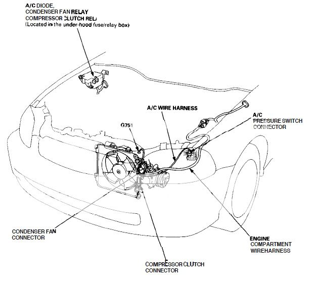

can someone please take a picture of the complete air conditioner system under the hood...
i have a 98 honda civic lx non-vtec, not sure if vtec is setup differ or not...
i bought the car and its missing the compressor, possible bracket not sure, condensor and fan, copper lines and not sure what else but i just need something to go off of so i know how they go back in...

thx!
but damn got any idea where i can pick up everything i need?

those pics r good i still need a pic of bracket for ac compressor

Scout your local junk yards.
