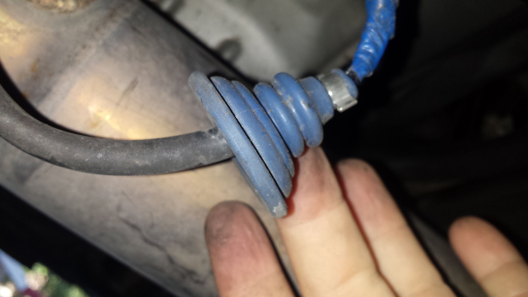

The O2 sensor has 4 wires. When you describe wire colors, first state the main color followed by the stripe color, for example Blk/Wht. For one color wires, just the main color, for example Blk/Wht. Better yet, post pictures of the connectors and the attached wires.

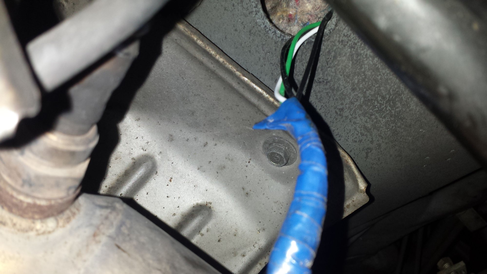

ok. I got some time to look at it better and take pics. There is one black with white stripe, one black, one green, and one white. there is no connector. Just wired together. black to black, green, to green, white to whit, and black with white stripe to black with white strip.

ok. I got some time to look at it better and take pics. There is one black with white stripe, one black, one green, and one white. there is no connector. Just wired together. black to black, green, to green, white to white, and black with white stripe to black with white strip.

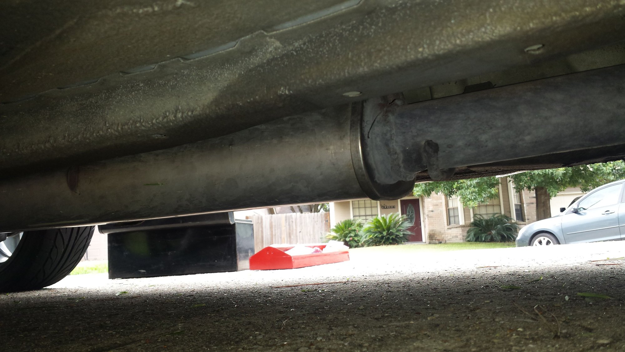

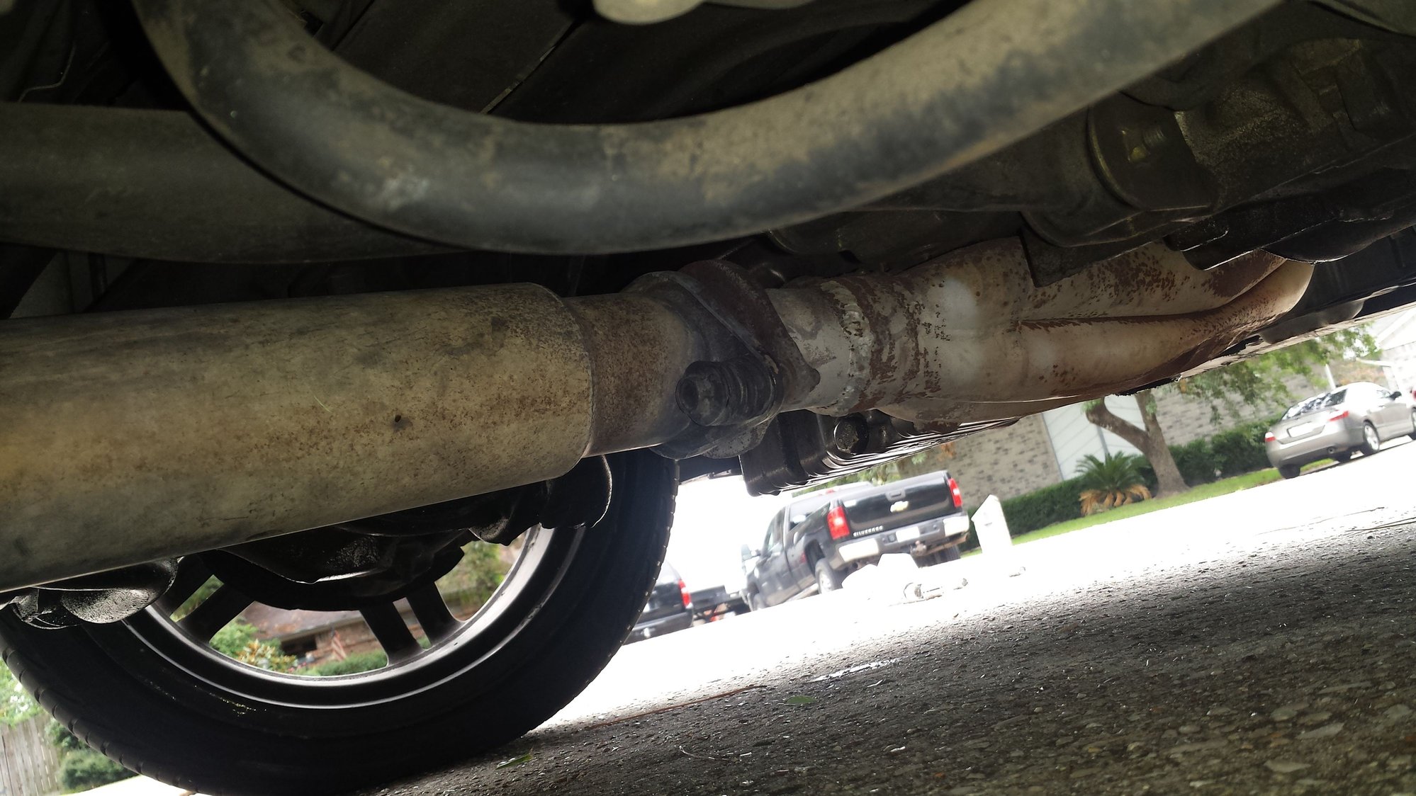

As you can see I posted pics as your requested. Do you think you can give me some feedback. Also I believe I have found a spot for my primary o2 sensor to go on my header. Looks like there is a plug in there. Can you confirm that plug is where the primary o2 sensor goes? Bad pic but the plug is in the top left corner. Thanks
