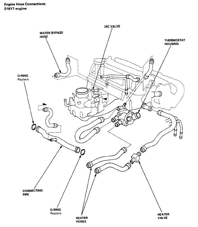

Default Identifying the hoses
which hose is this? And it is blocked so does it effect anything. Secondly what is the purpose of that U shape hose beside this blue marked hose? As my heater core is not hooked up
​​​​​​as you can see my heater core is not hooked up so where it goes?

Default Re: Identifying the hoses
It's your heater bypass hose
I think you are saying U shaped is heater bypass but what about the blue marked hose? Can you tell me why heater is bypassed?
Sure. The heater core isnt connected because the previous owner is dumb.
The u shaped hose is on the back of the thermostat housing and circulates the hot water coming out of the cylinder head before the thermostat opens.
Thanks but i am the first owner and the engine swapped from D16y8 to D15z6 so from then it is disconnected and I am from Pakistan so here mechanics are dumb and they disconnected it as they think it will not be used because of weather conditions.
Now I am confused may be the heater core is leaky or damaged and it is very difficult to inspect and remove heater core.
What is this hose for marked red?
Doesn't look like the heater core is connected to the engine, so you're not getting any heat.

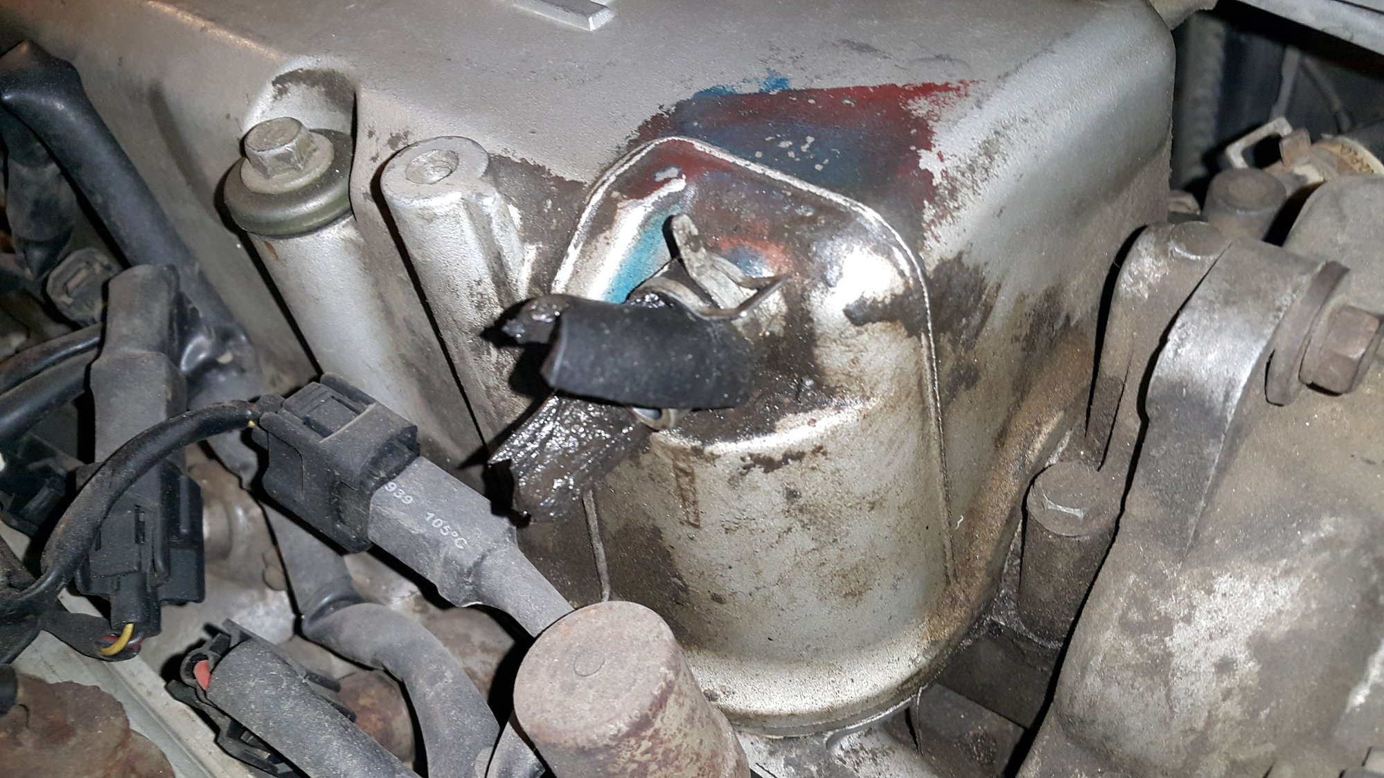

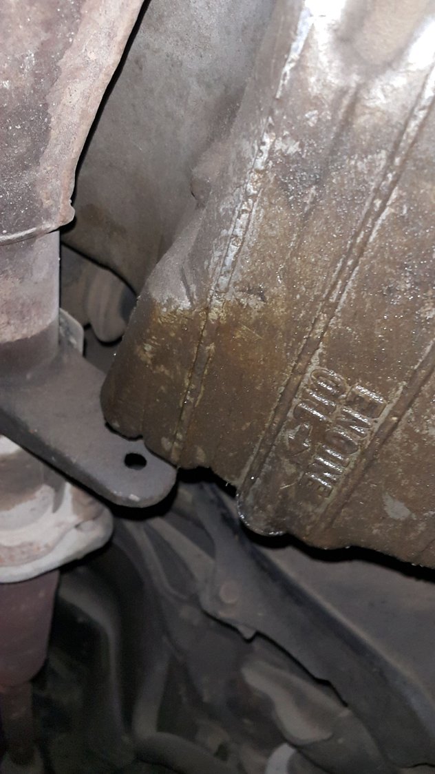

Default Distributer cap and oil pan civic 2000
The engine is swapped from D16y8 to D15z6. The car has more than 300k KMs on Odo.
I have recently changed oil after almost 2 years. I used 10w40. Oil level is not coming down but these pictures shows very bad picture. Is there any problem?
Also near the pcv valve the cover has oil.
Secondly how to clean these parts?

Default Re: Distributer cap and oil pan civic 2000
What about this red hose?
Secondly any test to check that heater core is in what condition? As it is very difficult to physically remove it and inspect it.
