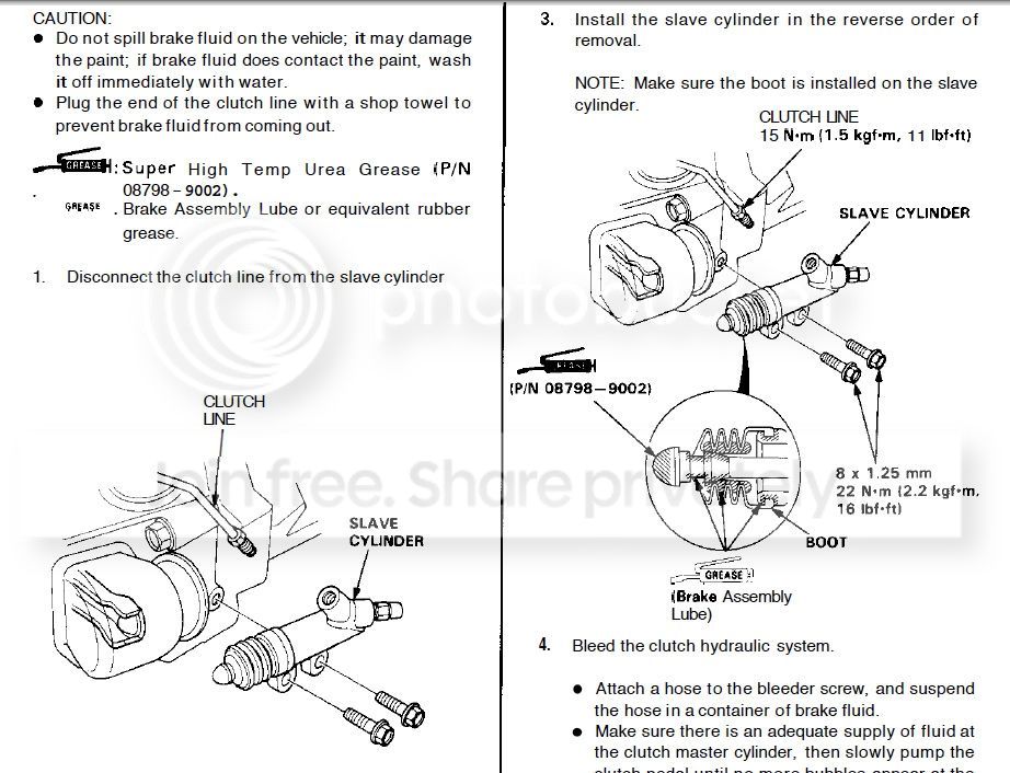

Yes it does, yes you should, and yes it would. The clutch pedal (and all the hydraulics) work to push the rod one way, separating the clutch from the flywheel. The pressure plate (which is on the other side of that ball) works to push the clutch back onto the flywheel. I'm blatantly over-simplifying it all, but I'm assuming you just want it to work and don't care exactly how it works.
That's the arm I'm talking about behind that boot. It's called a clutch fork. That one's broken.
That's a technical drawing, showing where the small "ball" looking part on the clutch slave cylinder rests on the "socket" of the shift fork. If those two parts aren't touching each other correctly, then you'd have the problem you're having.
