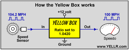

I do realize that this thread was originally intended to correct the speedometer 'needle' problems when installing an aftermarket gauge cover or possible JDM package,,, and now 4 years later!!
However, I thought I would shed a little light and maybe a new direction for those that are still stuck with no resolve or merely just wanting to FINALLY remove that slight deviation so that you can be "right on" and stop the worry when in need of absolute speed measurement! I have been using this devise on my motorcycle for years without any variation once initially set.
The Yellow Box by Black Robotics - www.yellr.com
Yellow Box Speedometer Recalibration
Acknowledged as the world's best speedo recalibrator due to it's advanced features
and tiny size, the Yellow Box corrects the speedometer and odometer of any
vehicle that uses a hall-effect speed sensor to generate the speedometer signal.
Features of the Yellow Box v4 -- Model No. YB4
# Corrects both the speedo and odometer by the same percentage/correction ratio
# Speedometer correction range; -50% to +100% (1:2 to 2:1 ratio range)
# Fine correction adjustment; 0.5% steps
# KPH-MPH and MPH-KPH speedo conversion
# Bright LED displays switch settings and test modes
# System testing on power-up, inbuilt input and output tests
# High-speed microprocessor accuracy, instant response, no speedo lag
# Fully digital, exact, instant adjustment
# Conveniently powered from speed sensor power
# Power supply voltage; 5 to 16 volt
# Very low power consumption (20mA)
# Tiny size; 37 x 62 x 14mm, weighs only 32 grams
# Rugged water and vibration proof encapsulation
# Strong mounting hole and connector strength
# Compatible with most modern motorcycles, cars and trucks
# Legendary reliability and 10 year replacement warranty!
Check their website for specials. I hope this helps.
