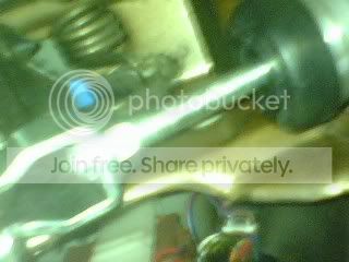

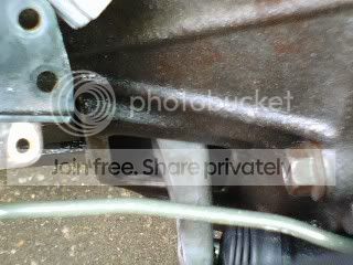

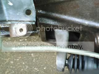

Re: (turkeyslow)
I played with it for hours today and im right where I was 6 weeks ago.
here with no pedal
full pedal
and its adjusted at its furthest most point and im only getting that limited travel
here with no pedal
full pedal
