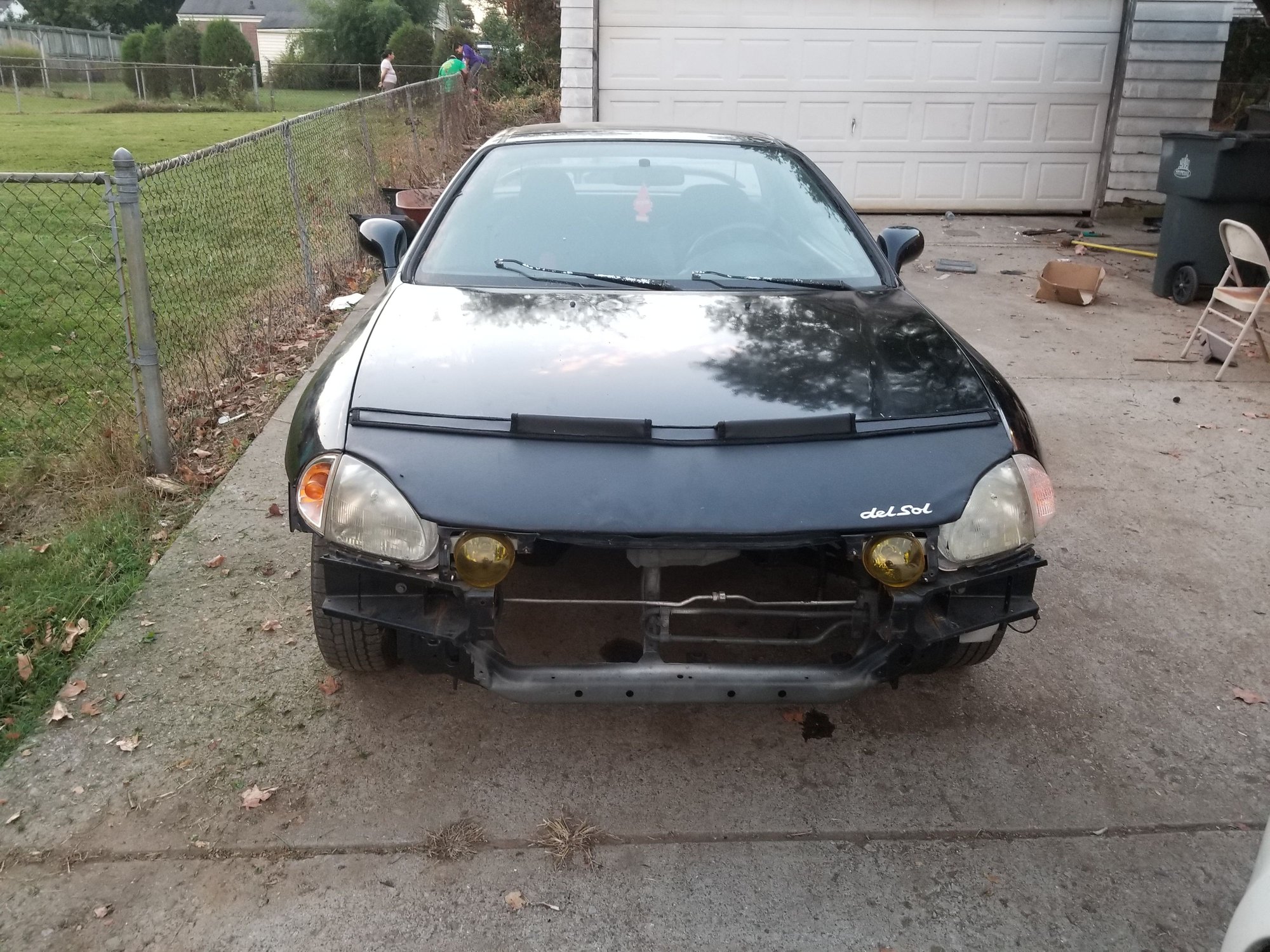

hey everyone, I'm going to be doing a build on my del sol over the winter and spring. I bought the car completely stock back in January so here is my build plans css block, forged pistons, The new speed factory rods or Manley rods, built head, arps, King bearings, skunk 2 Intake manifold, Percision 5531 turbo cast manifold 3 inch downpipe tail wastegate and bov ATI damper more to come later here's some pics up till now..

That's how it was for a little while, then wanted to go k swap so I sold the swap and kit. Just to turn around and build a z6 that's where I'm at now current time. I'll get some pictures of the car how it's sits tomorrow.

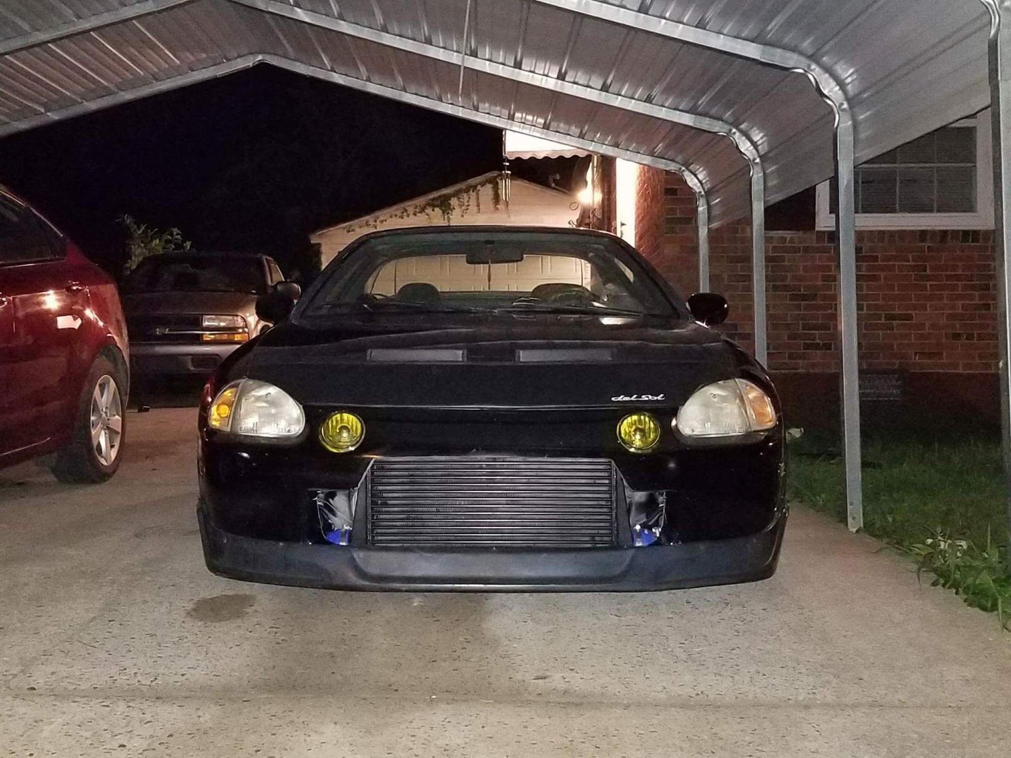

This is how it looks as of today, I'll post my build list up tomorrow with my budget. Please feel free to comment,
