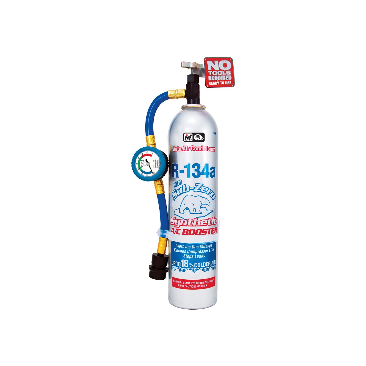

So I recently bought this car for a road trip and the AC is blowing warm. I went and bought one of those freon cans thinking I could just pump some in and have a quick fix for the short trip. Unfortunately, after turning on the AC, the low pressure reading is WAY WAY too high. The needle on the gauge goes FAR past the red zone, to where it cant go any further (Screw to Screw). The compressor seems to be kicking on. When the AC is switched on the air picks up and the engine clearly sounds like it is drawing more power. What could be causing this? And about how much would it cost to fix? if its $100 or under it might be worth it.

The pressure reading was way over 80psi, THIS is what i was using. Here's a larger image as well... LINK
Also, I never actually filled the system with any freon. The pressure was just way to high to think about adding more. Before I even cracked the can, i just used the hose to check the pressure to see if it was even worth trying to fill. I called the company who supplies the can and asked if it would give a different reading whether the can was cracked or not and they said no.
I havn't done anything to the A/C system at all. Like i said, I just recently purchased the car.
As far as a high side reading...i unfortunately don't have the equipment to check it. Is it possible to borrow or rent the equipment from an auto parts store? Also, what would i be looking for in the high side? I mean, if there IS a clog, then should the high side be at an extremely low pressure? I just want to gather as much information so that if it isn't something fairly simple then i can at least supply a shop with a good deal of information.

You are overcharged. In order for a high low side pressure to occur it needs to travel through the high side. If you or somebody else has charged it through the low side to fix the air assuming that there was a low charge and there actually wasnt, there is probably a clogged expansion valve. Do some further investigating and change the expansion valve, drier, evacuate, charge and report results. Hope this helps.

/\ yeah, you need to do some more troubleshooting than just a low side pressure. Follow his recommendations, a solid starting point is first finding out if the compressor clutch is even engaging.
When an AC is turned OFF, or the compressor is not running the high and low side pressures equalize, so the low side goes really high (past what some of those cheap little gauges read, even when undercharged) and the high side drops lower than it usually is.
