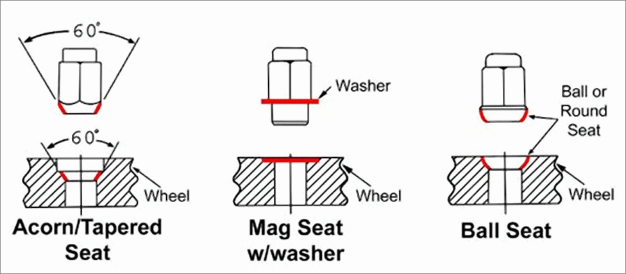

I currently have Gorilla Acorn lug nuts on my steelies.. you're saying those may loosen up? I'm pretty sure what was on before was also aftermarket.

You need BALL SEATS not ACORN/TAPERED SEATS (on Honda OEM alloys)!
Hope you don't mind a copy n' paste...
is this the lug nut i suppose to use?
you could get this at autozone.
Nope!
Those look like the typical 'tapered lug nuts' that most ppl use by mistake...
LoL!
When their HX & Si alloys fall off... they *think* some lunatic is stalking them... loosening their wheels at night, yada, yada, yada.
Honda OEM alloy rims have 'round' a.k.a. 'radius' a.k.a. 'ball' seats and they take special lug nuts!
Like I said, the only place I've seen them is at Honda dealers...
That's NOT to say other ppl don't carry them - I've just never seen them in the wild myself!
Heh!
Don't believe me?!?!?
Here you go...
Muteki Super Tuner Lug Nuts
Read n' heed!
Nope!
LoL!
Heh!
Here you go...
Read n' heed!
Just get some aluminum ones and crank em down real good they'll end up round haha. But my lugs are aftermarket and are rounded like in those pics. You make a very good point though, I was wondering if there was a difference
