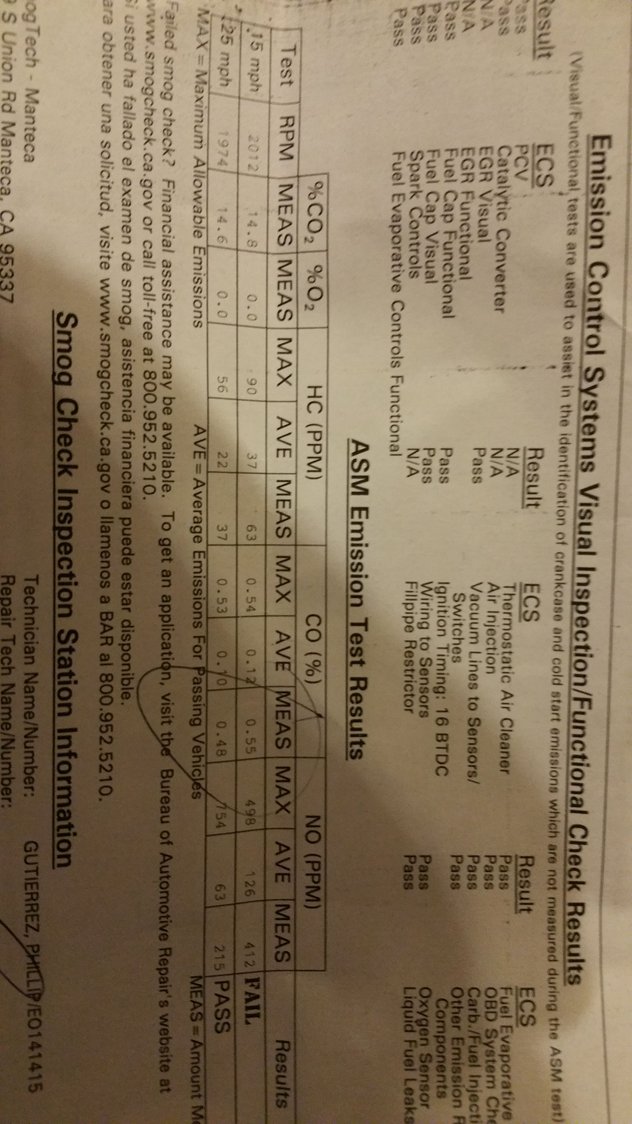

Old 10-31-2015, 08:00 PM
Hondalosser's Avatar
Join Date: Oct 2015
Posts: 5
Default Re: banging my head against my smog test.......
here you go and it the most recent.
So...what did you fail?
edit: you posted right when i posted.
What did the person who performed the test say?

Old 10-31-2015, 08:14 PM
Former User's Avatar
Join Date: Feb 2008
Posts: 45,219
Received 44 Likes on 22 Posts
The data point to a bad cat.
there you go, you didn't past co so yes it has to do with your cat. You can try those bottle formula's.
