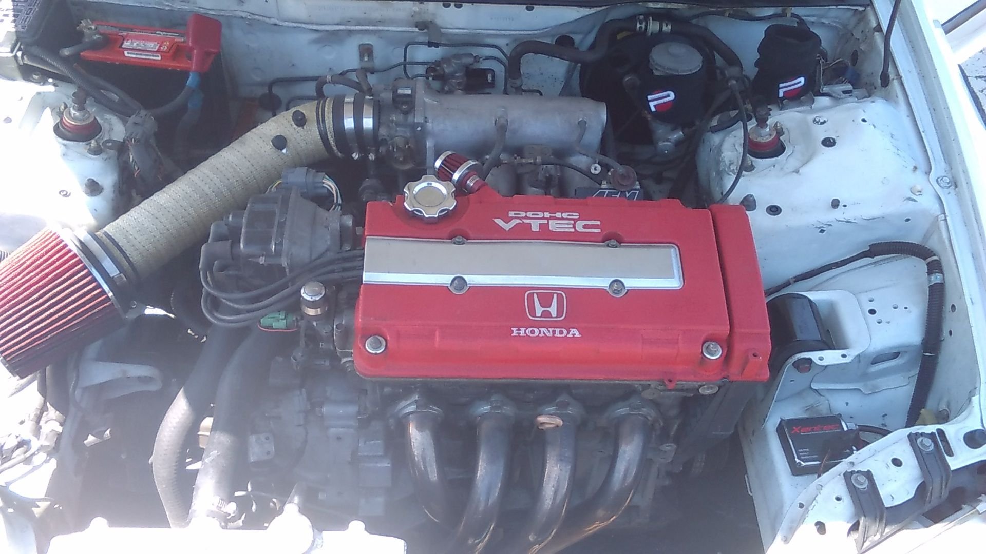

I might as well introduce myself. New to H-T & the eg chassis / b swaps. That's a lot of "new" to so please, bear with me.
Pic of said swap:

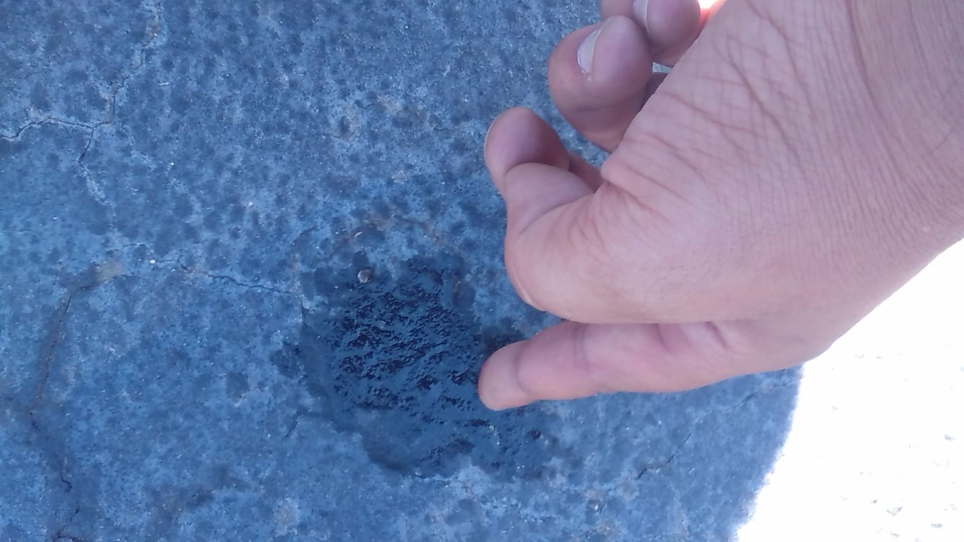

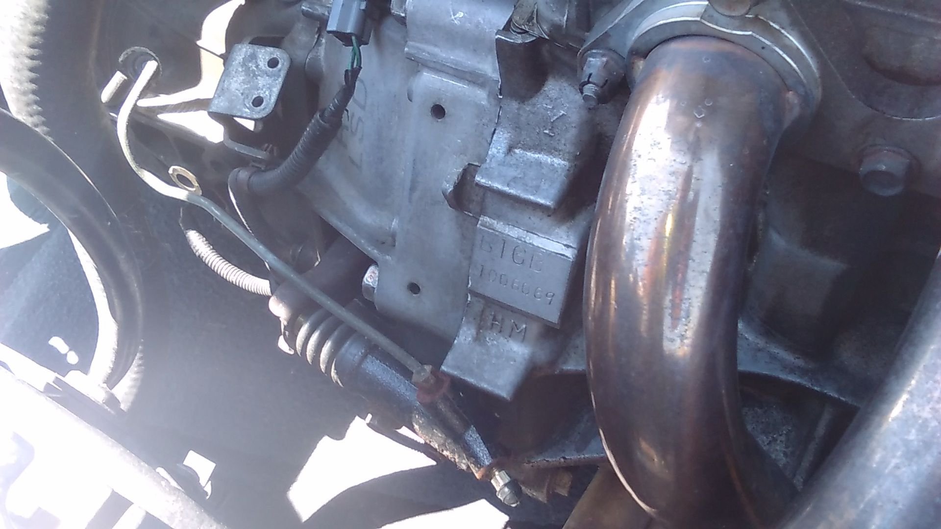

Pass side, something else is leaking. Looks like gear oil.
From the trans. Drip, drip, drip

Pic of said swap:

As far as the leak goes....you'll just need to find where its coming from.
Axle seals are a common place.
Or if someone tried to put a prelude axle in the passenger side without swapping to a B series inner joint...the trans will leak past the axle.

The leak just collects @ the trans housing & drips some. Was told to check the reverse sensor haha
