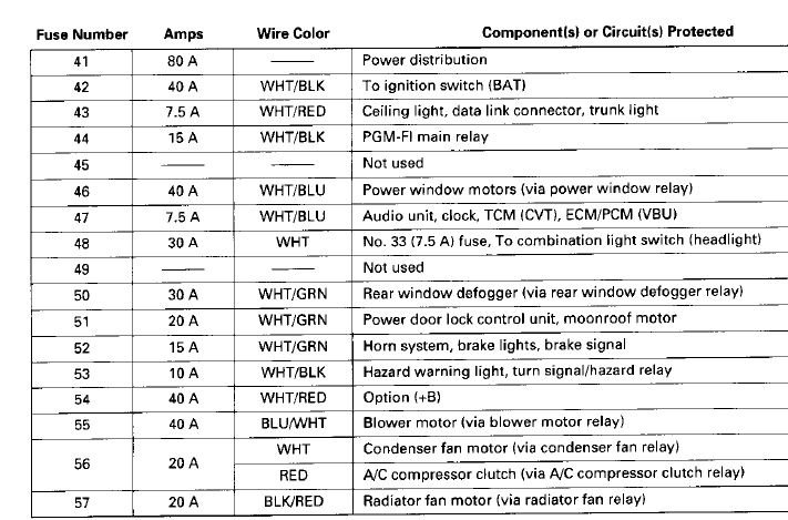

Triple check your wiring job. Something with the main power distribution went wrong.
Start by checking the 80A hood fuse.
https://honda-tech.com/forums/honda-...fuses-3079359/

Voltage test the 80A and 40A fuses (41 and 42). See link I posted.

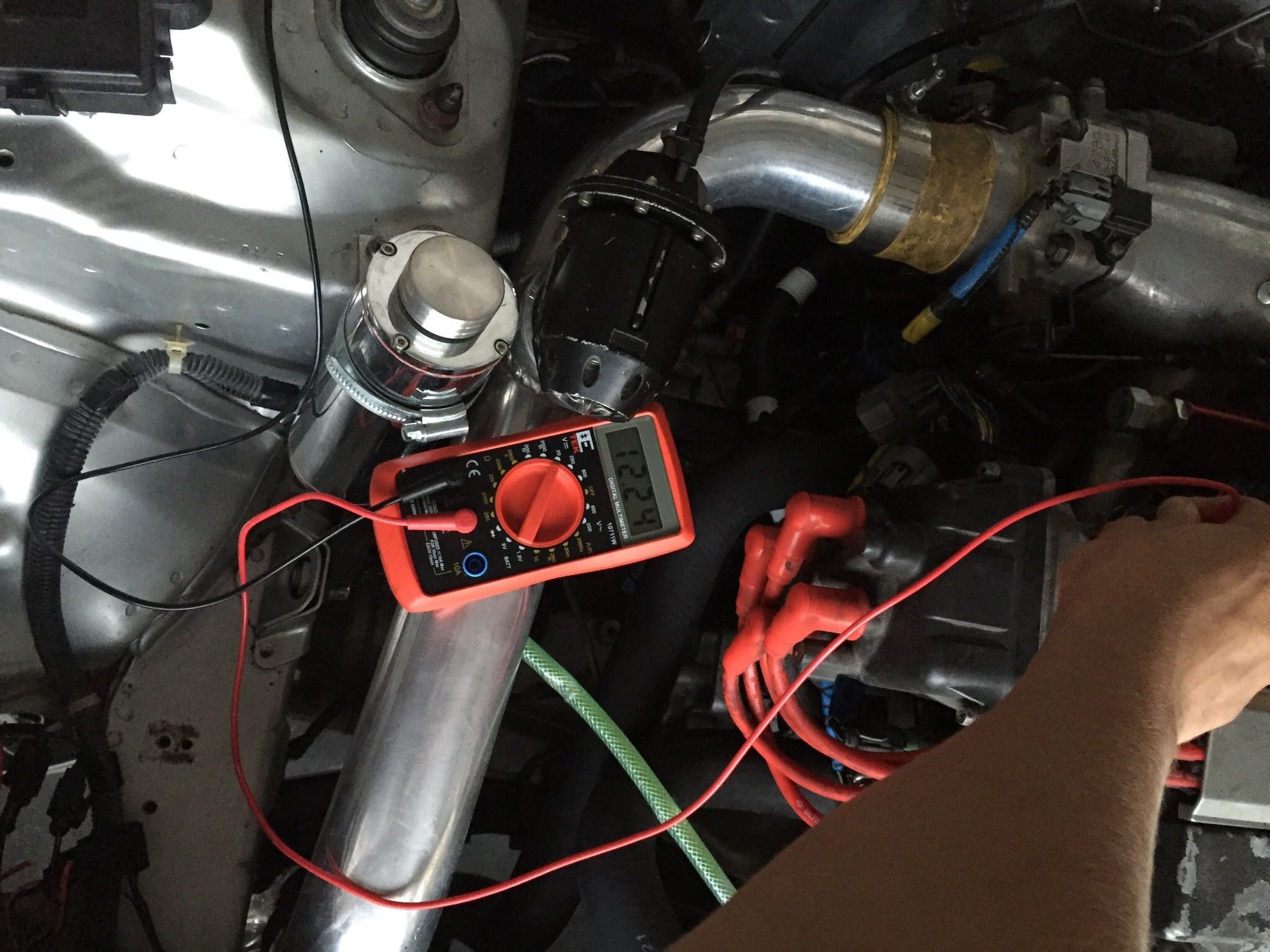

I just checked all my grounds again and they all read 12.5v even the transmission ground
I'm sorry 12.25v
Old 07-25-2016, 07:27 PM
mk378's Avatar
Join Date: Feb 2016
Posts: 3,018
Received 46 Likes on 43 Posts
Default Re: 99 civic has no power when key is turned
Put one meter probe on the lead post on the minus side that is part of the battery (not the terminal that is part of the car). Put the other probe on the frame or the engine. The reading should be very close to zero volts.
Do this test with the headlight switch on and/or someone turning the key trying to start.

So this is with the headlight switch on and someone turning the key to start.
