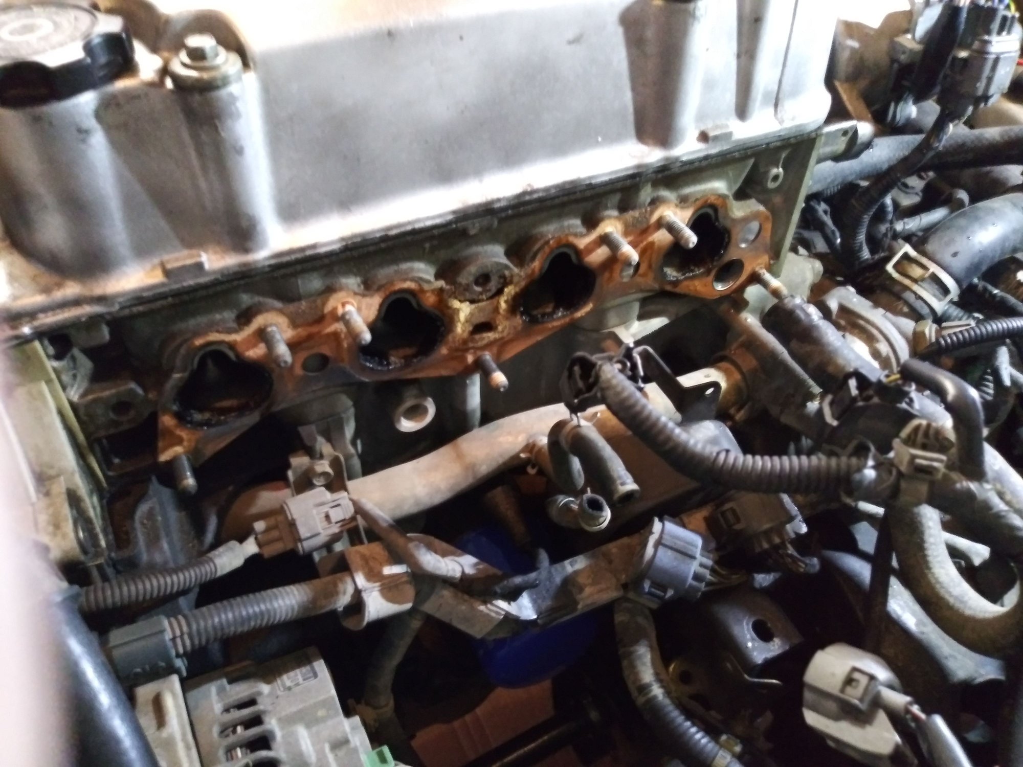

Bowing that fuse is usually from a gray or bad ground on the thermostat housing, or a frayed wire on an oxygen sensor
Unplug your alternator, the connectors for the oxygen sensors and put in a new fuse.
If youre that dedicated to a new harness youre going to have to remove your old harness, at that point you might as well just peel back the electrical tape and inspect your old harness and fix it yourself . nearly all of the harness is under the intake manifold

Drive up on ramps and work on it from underneath. You should not need to take a lot apart. Another option is to disconnect that part of the harness from everything on the back of the engine and detach it from the clips, then pull it out over the starter so you can work on it easier.
