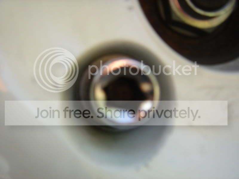

I also need your guys' help, My wheels have a wheel lock but I no longer have the key and was hoping you could direct me to where I could find a replacement. The key is house shaped and looks like this..

clean man, where are your center caps though. anyway digging the five lug. you could try a rim shop or something to see if they have one. you could try sears they should have a removal set but not sure it will fit between the space around the locks.

hammer on a 19mm 12-point socket, and twist off, buy a life-time warranty one because you mught damage the socket
