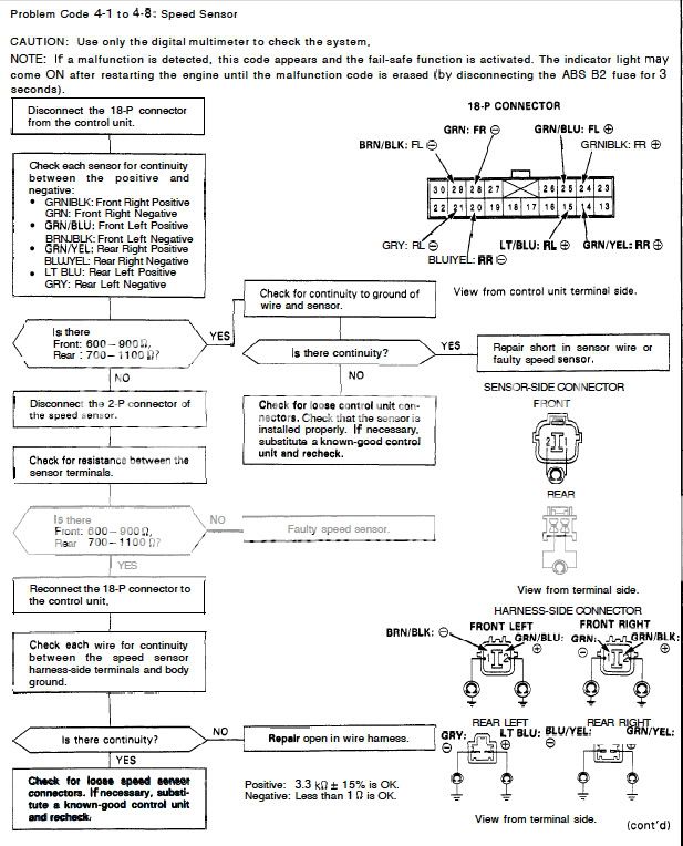

4-2 Circuit of left hand front wheel speed sensor
Thats is the Code that it gave me any ideas? When I was putting the suspension on I pulled the brake and heard a cable pop I was like OOOO lol but when I took a look it was just a rubber part that had broke didnt seem important. I dont know if that has anything to do with it. Thank You.

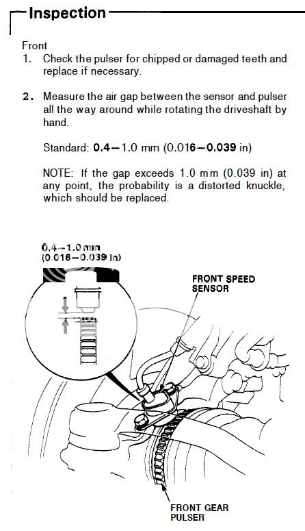

Inspect the speed sensor and its wire for that wheel:

I inspected the sensor and wire, and they seemed to be in really good shape. I am going to try and clean it, but if that does not work I dont think i want to spend that much money on a new speed sensor. Is it worth to just get that off.

Pull out your trusty multimeter:

The code list is in the diagram right above your text. Also see post #3.
