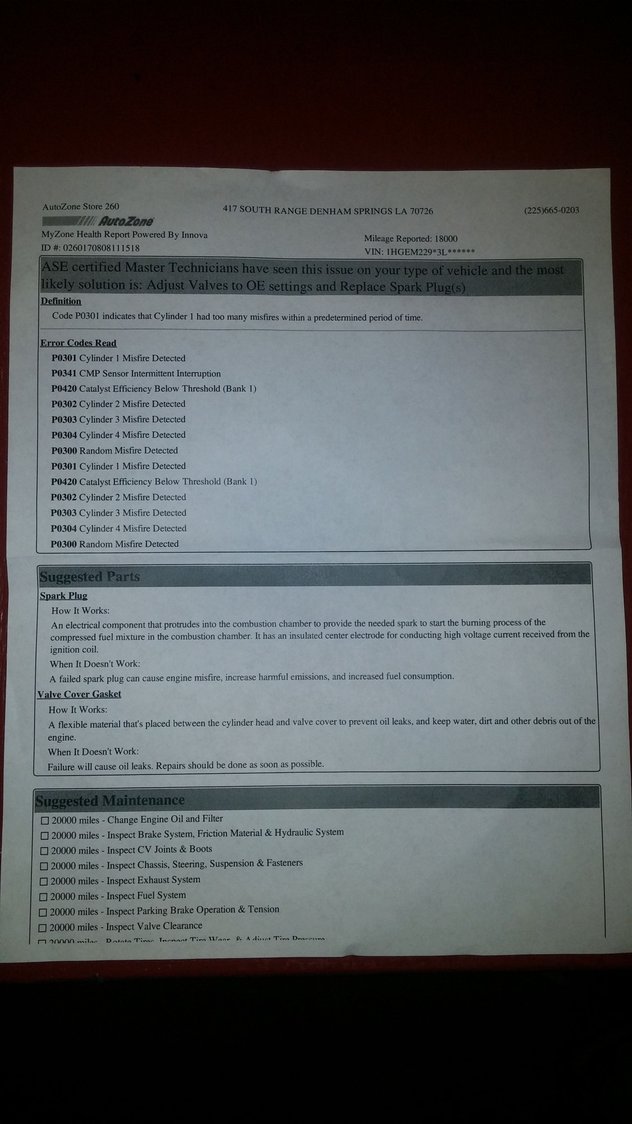

Let me start by first saying hello to everyone. I am a new Honda Civic owner, I have never actually owned a Honda before. I have read quite a few discussions on problems similar to mine but not quite the same, so if this has been discussed I do apologize. I just recently purchased a 03 Civic EX. Let me start by first showing my trouble codes.
I have major misfiring going on. From what i have read on this site i dont believe its the cat causing misfire. More so the misfiring causing the cat code. The girl i got it from also just had the timing belt changed and reset. All the plugs look okay. They have been changed also. I dont think the cam position sensor has been changed tho. I have also read that it could be my valves needing adjusted, but I'm not sure if it's that, because they are very quiet. And I don't hear any noise from the actuator either when started. On a really cold start it takes about 10 to 15 minutes for it to start missing, after its warmed up it does it. There has been a couple times when i would kill it and try to start it wouldnt start. I would let it sit for a few minutes and it would start back. There has only been one time that the engine has died on me and that is when I was on the interstate driving about 60 to 70mph and it started to mis and jerk violently. It took sitting for about 10 minutes to restart. Of course after that i havent went over 40mph. Actually i stoped driving it completely. Do yall think it could be the cam position sensor? And is there a way to check it first? I say that because I can't afford to be buying parts that I don't need. Or has anyone seen this before? I have seen a bunch of cat codes problems on here but not with these codes to. Thanks!

With that quantity of codes, I would tend to think that the timing belt wasn't installed properly and that the belt has skipped a tooth or more. This could easily cause damage internally (mainly to the valves), so I would suggest getting it towed to a reputable Honda dealer and having the timing belt inspected (if you can't do it yourself).

Thats what did happen a couple of months ago. She had the belt replaced and it was still running bad (missing). She then went to another shop and they told her just that. That the belt was installed wrong and it skipped a couple of teeth(i have all the invoices and called them today) they said the belt was good. They just set it properly because it was wrong. Tomorrow i will break it down and have a look at it.

The D17 is an interference engine. So, if the belt was off a bunch of teeth, you've probably got a bunch of bent valves in the head and will probably need a new engine.

It was off by two teeth when they checked it. Thanks for the advice but i hope i dont need a new engine man lol. Im certainly not jumping to that conclusion yet.

You need to diagnose, not speculate. Start with the big stuff. Make sure your mechanical and ignition timing are set properly.
Check compression and leak down to tell if there is any damage.

Just wanted to give a update incase anyone else has these codes ever. I didnt really get any decent advice on here at all. Except check compression and it was fine. I checked my camshaft position sensor and it was bad. I changed that and my plugs and reset ecu. Checked timing and its right on the money. No codes and she runs like it was brand new. Crossing fingers it stays good. And btw i already knew it had codes on it. It was misfiring. I figured it wasnt that big of a problem. And it wasnt. And i got the car really cheap. Its a super nice little car. And in really good shape so well worth the 150 bucks put in it!
