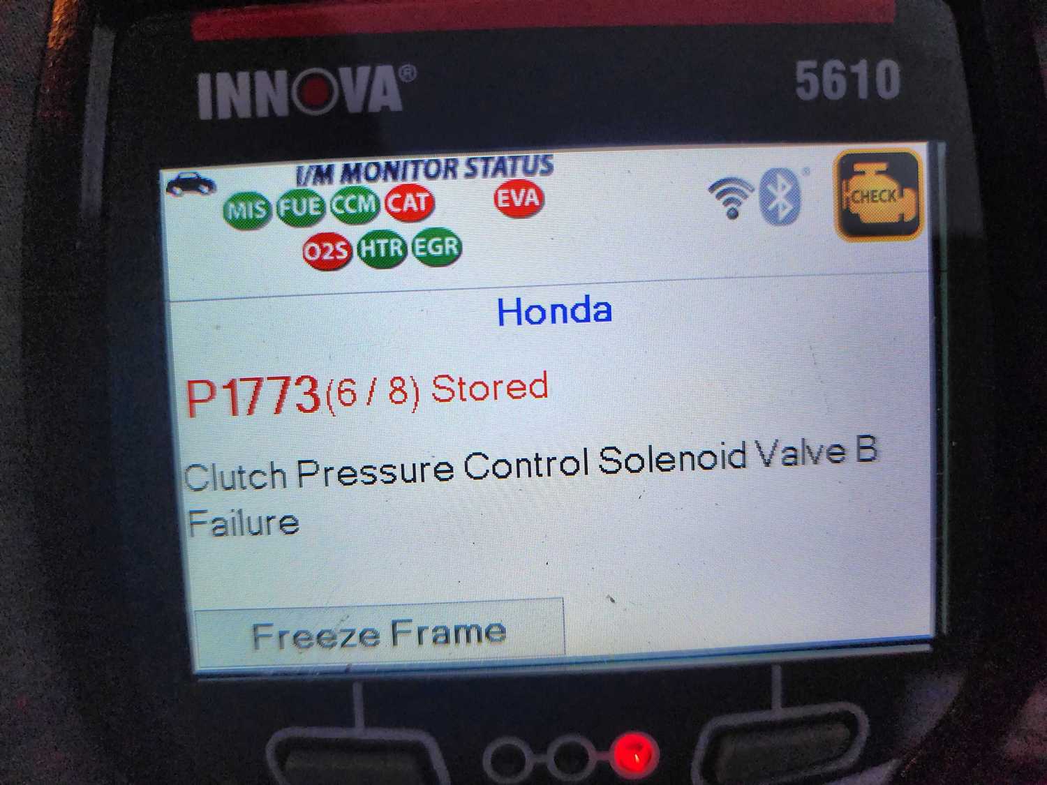

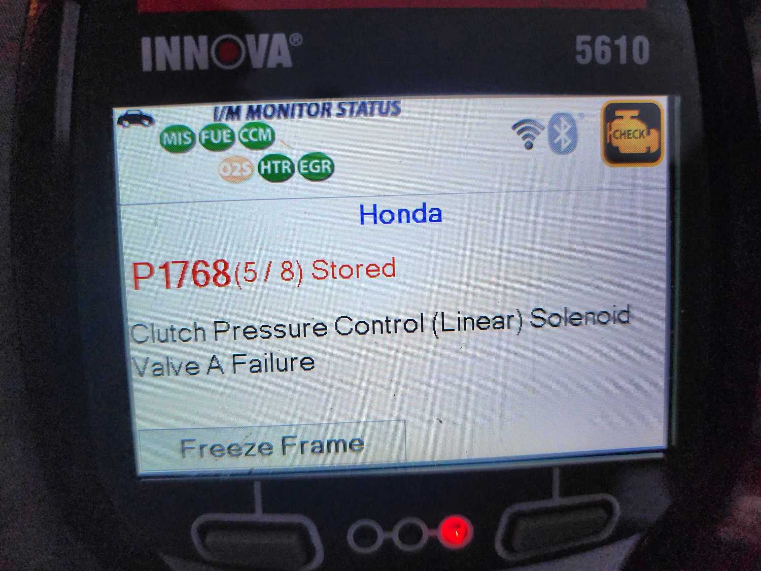

P1706 A/T Gear No Position
P1773 Clutch Pressure Control Solenoid Valve B Failure
P1768 Clutch Pressure Control (linear) Solenoid Valve A Failure
P1753 A/T Lockup Sol A Failure
So I am trying to figure out a way around this. The 02 CIvic was a manual trans so it did not have the connector C to plug into the ECU like the Auto trans
car had which is why I am getting all of these codes. Is there an ECU that exists for a manual and VTEC 02-03 Civic? That is what I am trying to find out.
Or is there another way around this that anyone knows of? Can I modify the ECU? Can I take the Auto trans part of the harness out of the 03 Civic and
plug that and all of those sensors into the ECU? LOL. Any advice would be welcome. Thank you!
