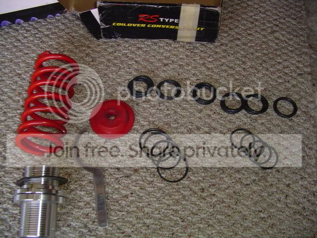

just picke dup some from some guy for 20. well see how it goes but i have a question
where do i place the rings that it came with?
here are soem pix that i have so far and if you guys help with this ill get more pix and feedback on the ride thanks

you use those rings between the shock and the inside of the coilover sleeve. They're meant to reduce the amount of movement between those two piece.s

Rubber rings go around the strut so the coilover sleeve fits tight. It's up to you if you want to use that red rubber thing or not, I wouldn't. Just use the rubber insulator in your top-hat from the factory.

that red rubber **** is crap,
don't use it,
all it does is reduce your suspension travel/stroke, and cause you to bottom out sooner at the same ride height as if it were off.

ok because i have 3 differnt types of rings. i have 12 fatt rubber ones, 4 skinnier ones and 4 metal ones. im guessing 2 fat ones on each strut 1 metal one on the bottom of the sleeve between sleeve and strut, but i dont know about the skinny ones. thanks

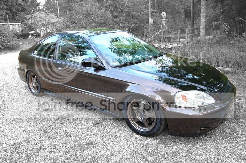

Stock shocks / Cheap-a$$ coilovers FTW!
Going on 2 years with the same set up...
Ride's kinda stiff, not bouncy, just right for me.
Rear struts creak a little on turns, but f-it... I always have music on.
Cheap & low

I'm loving that color on your civic. Nice choice!

Thanks man.
Smokey Brown Metallic / Flamenco Black Pearl (across the top) ---&gt; The crappy photos (shot by me... which is why) don't do it justice. I just got it back a month or so ago so I haven't had a chance to have a "proper" photoshot of it's chocolatey goodness yet.
Should be doing a shoot soon with my buddies DA (who's bro painted both our cars).
