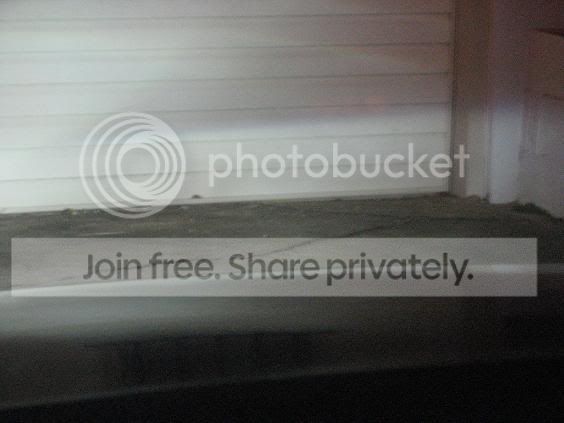

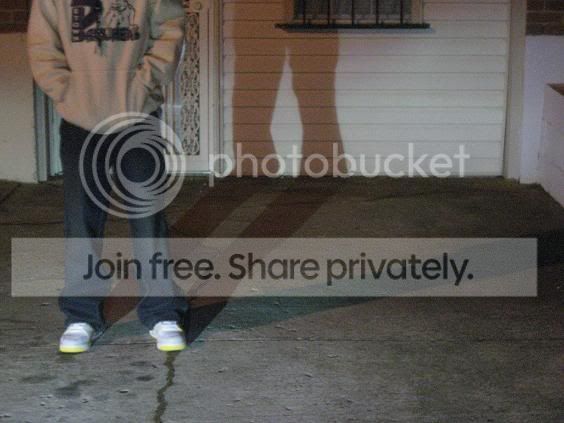

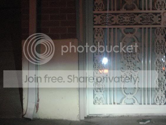

So i tried to aim my headlights up today again, and found out my pass. headlight wont aim up. It aims to the ground while my drivers side is the one that is normal or pointing up.
Hes standing where the pass. side light sits and aims.
Passenger Side.
Drivers Side.
So is the whole headlamp on the right side messed up? and needs to be replaced?

did you use an hid kit for a DC? 9006 bulb bases? Or, did you rig up some different base bulbs? Try adjusting the light front the mounting points...4 ten millimeter bolt heads... loosen all 4 bolts and try to tilt the headlamp up.

For each headlight there are two on the top of the radiator support, and then two lower bolts on the radiator support by the front frame rails.
