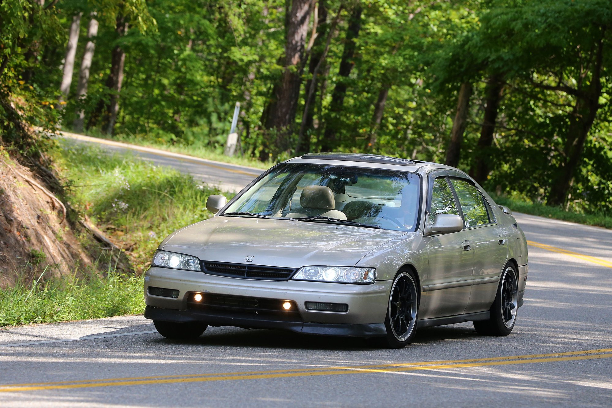

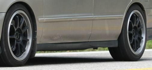

Here's a whole bunch of wheels in various specs I've had over the past coupe years. Some a little more aggressive than others. Take a look and let me know what you like. As far as recommendations, I'd definitely look into 17x8 with a +25 to 35 offset, and if you want 17x9s, I'd say somewhere +35 to +40. My 17x9 +35 with 245/40s is my favorite fitment and I had 0 rubbing with just the fenders rolled.
17x9 +23 front 17x8.5 +32 rear Volk CE28s, 235/40/17s

17x9 +40 front +35 rear Racing Hart Tracer Type Cs, 245/40/17s

17x8 +25 Desmond Regamasters 215/45/17s

17x8 +35 front, and 17x9 +20 rear 5Zigen FN01R-Cs 215/45/17s

17x8 +35 square 5Zigen FN01R-Cs 215/45/17s

17x8.5 +24 215/45/17, 17x9.5 +28 235/40/17 Racing Hart Type Cs

17x8 +30 front, 17x8.5 +35 245/40/17

Thanks man definitely appreciate the photos with the captions, this was alot of help and I think the 17x9 +35 with 245/40s is my favorite too, also just wondering, what are you lowered on and any suspension mods?
I'm currently running Koni Yellows paired with Ground Control coilover sleeves, and FFC extended top hats. I also have a full Tanabe Sustec sway bar set, as well as a good amount of other suspension/chassis upgrades for better handling.
