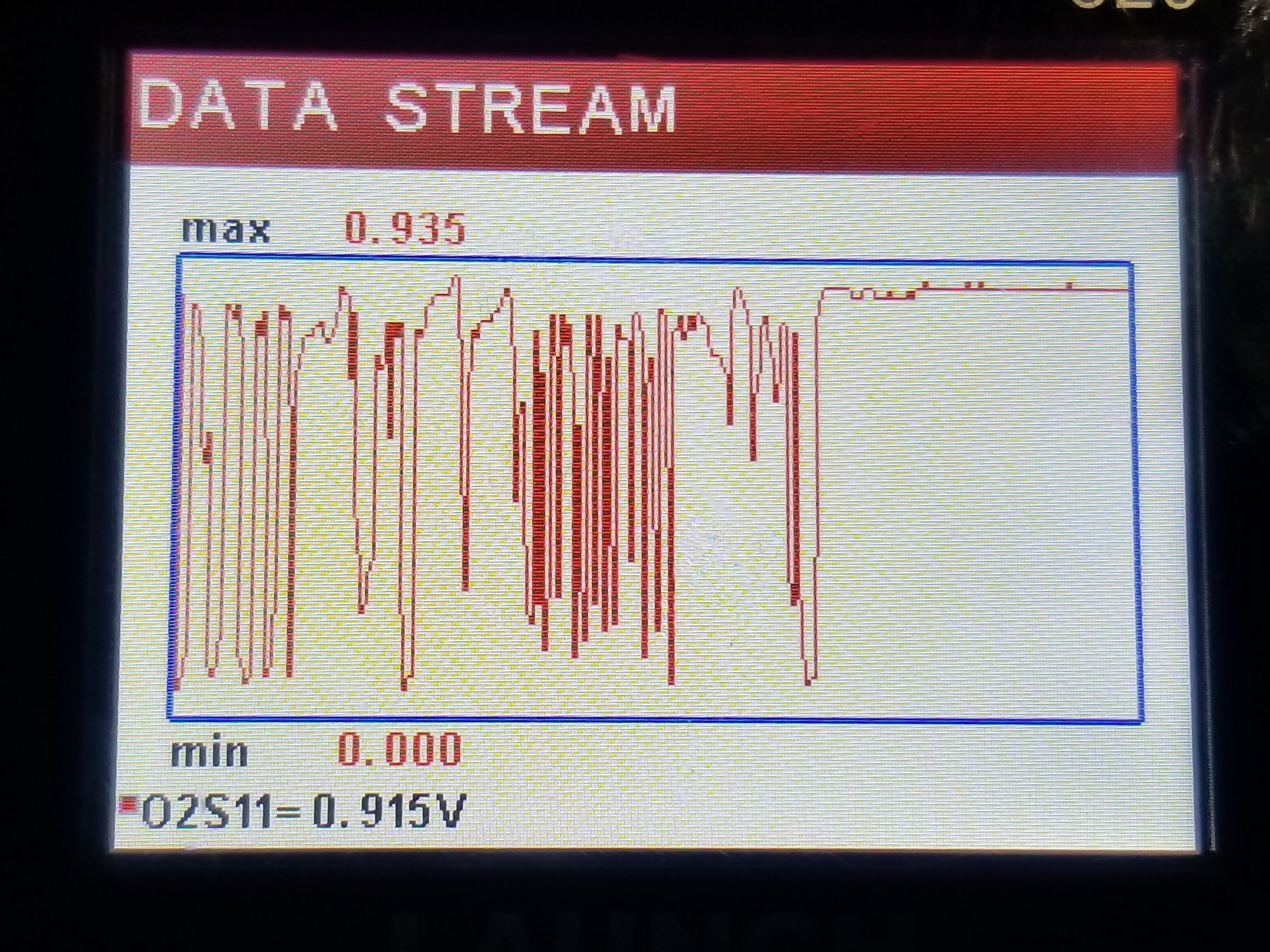

Took a quick drive with the O2 sensor disconnected, and the idle didn't change. The car was a bit slower and threw an O2 sensor CEL from the start, but that's it. Drove a bit with the scanner reattached, and below is a graph of the O2 sensor voltage. Flat high spots are closed-throttle deceleration and idle. Note that the scanner doesn't have a fast refresh rate (only $50).

Yeah, unless you really racked up the miles, that Denso O2 sensor should last longer than 2 years. So if nothing changed with it disconnected, something else is wrong.
The O2 code you got is because of unplugging the unit. I sometimes think Onboard Diagnostics only checks for the presence of the O2, but not its health.
You seem pretty handy with diagnosing things, so perhaps hook your scanning device up to the unplugged IACV to make sure its Ohms (resistance) are in spec. They can go out of spec without showing a code.
Maybe try these tests. Leave the key in the Off position.
Test 1. Setup to measure Ohms, Probe the IACV terminals (not the plug) and look for between 8 and 15 Ohms. Those numbers are for my 4th generation; your 5th generation may differ.
Test 2. Set up to measure Continuity, and check for continuity between each terminal of the IACV (not the plug) and a ground. There should be NO continuity. If continuity is found, the IACV is bad.
