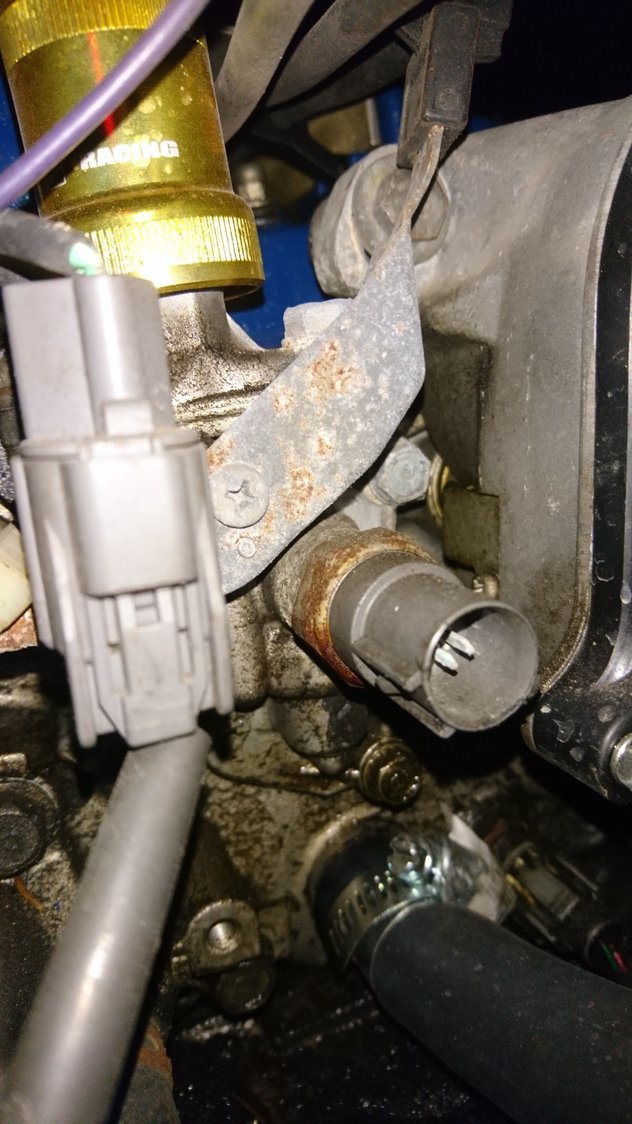

oh damn haha i didnt realize that a buddy of mine who is a mechanic told me its probably my tps causing the bouncy idle and start and stall in the morning now that i think of it its the only thing i didnt clean ill give that a try in the am and test the coolant sensor. could this maybe all caused by an air bubble in the system or the tps? im assuming its the one on the left next to coolant hose

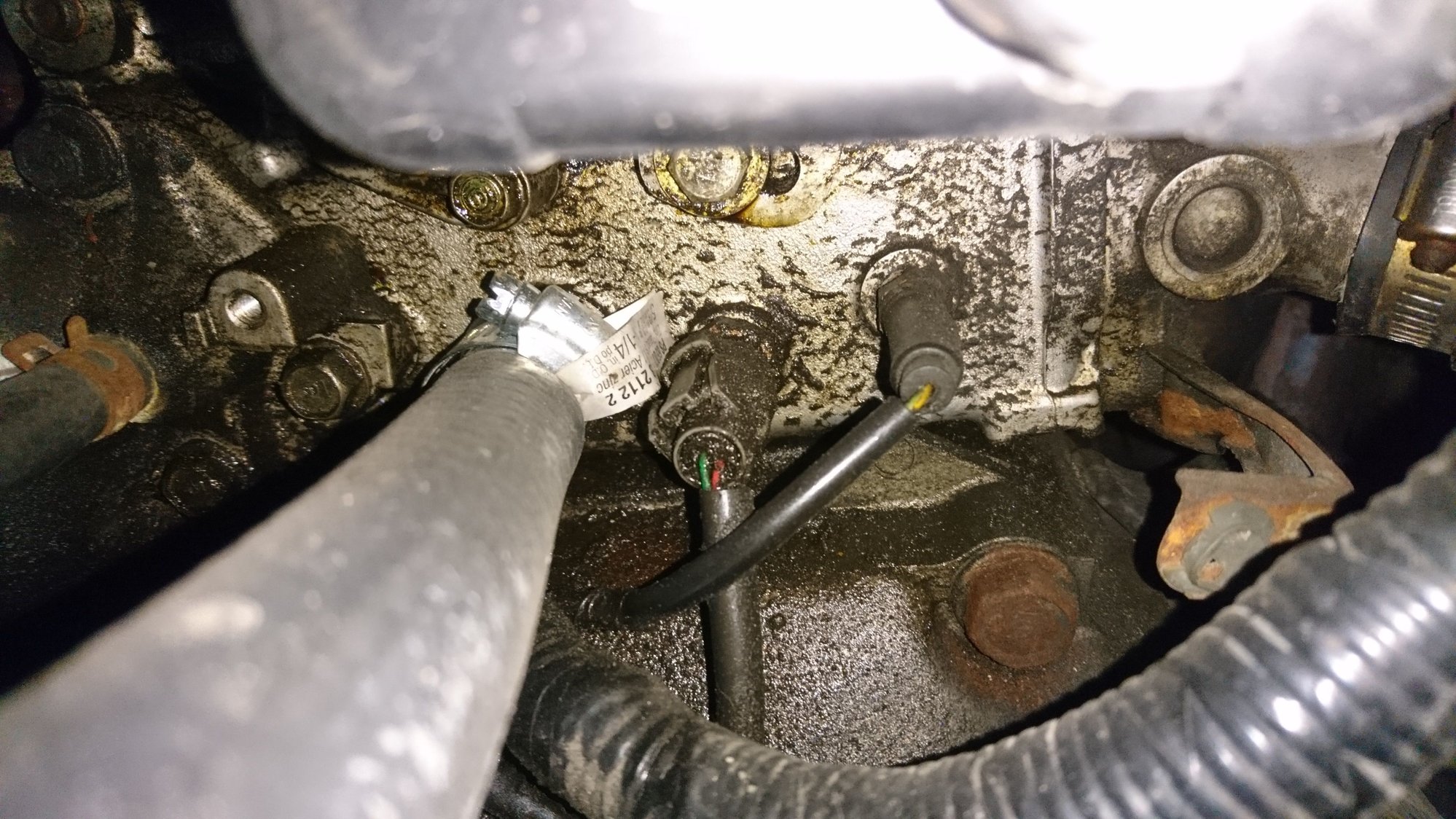

i also have this thats unplugged under the vtec solenoide tho its never been plugged in. nore do i see a connector for it in the bay

well this morning shile changingmy clutch slave i decided to try testing that temp sensor while trying to get the connector off i almost ripped the thing out of the bung so im assumong thats the problem. anyway ill change that out and update

when you get the connector off, with the ignition off, spray that connector out real good with some electrical parts cleaner, both inside and outside where all that crud is, get it nice and clean
