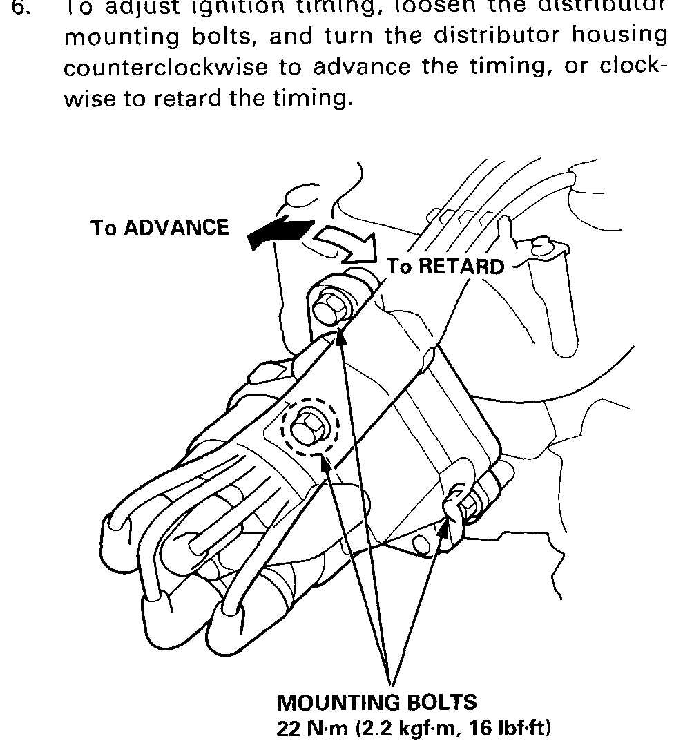

Hi guys, I have a 96 accord 4 cyl vtec auto trans, my issue is my timing is off and needs to be adjusted, my distributor is slotted, someonesaid this is not possible and no adjustment is available, but is clearly slotted 1 inch or so, can someone explain why a 96 has this? thanks,,yes i know how to jump the obd1 serv. port and such, just wondering about the hodge podge of parts on this car, it was brought brand new off the show room floor, i am the 2nd owner and it is all original except the muffler and air filter,

Here's a page from the OEM shop manual. It is definately adjustable....
Wow, that picture came out really BIG....

well they were correct. A 96 has crank angle sensors in the dist and another sensor on the crank. The 96+ are not adjustable and are obd2 not obd1.

I will second that. Woody, the manual was wrong (ya, that happens). In 96 the timing is non adjustable and controlled by the ECU.
On Edit I attached the PDF where Honda recanted the adjustability of the timing at the distributor. Scroll down to pg 5

the funny part about that dizzy on the 96 is that it will look like you have nice big slots. Probably bc honda kept using the same cast. However one of the god d** things doesnt have anything but a hole for the bolt haha I went through all of this when I turboed and went back to 0bd1 for tuning purposes. It was a pain. You just need to check your mechanical timing then check the timing with a timing light and the service port bridged under the dash. If you dont jump the port the computer will automatically adjust timing so youll never see the true timing that the belt is set at.

Thanks for the heads up on the shop manual error. I stand corrected!
