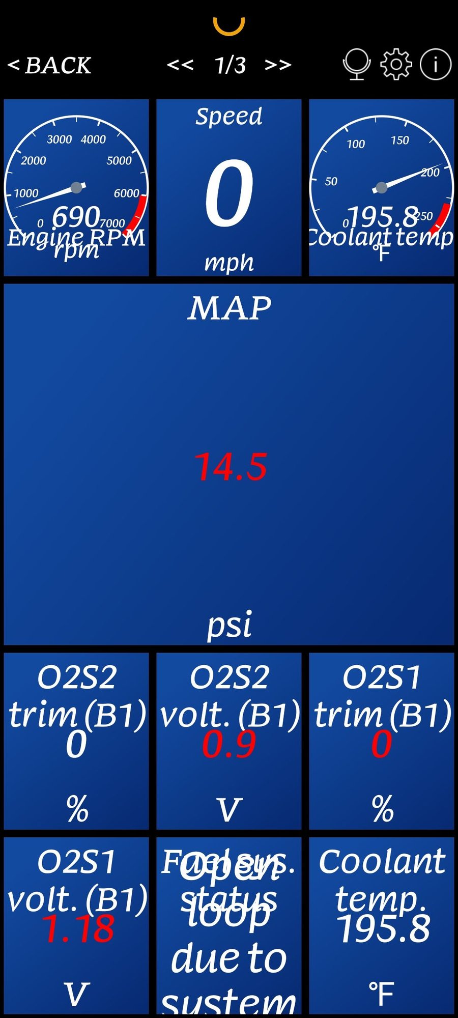

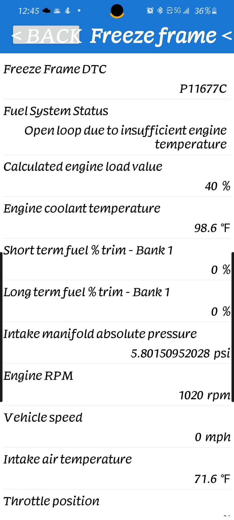

I do have a Bluetooth OBD2 reader with Car Scanner app. It gives boat load of info. Most I don't yet understand, lol. Oddly after changing the MAP the code sorta changed. 🤨
Now it's P11677c Insufficient engine temperature. I'd be guessing the ECT sensor?
Will attempt to add some pics.
I can easily get more, or specific pics of data. Sorry for any duplicates.

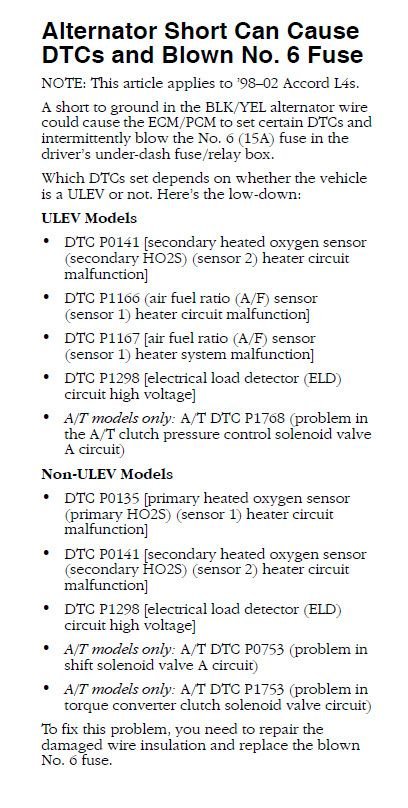

Also, this is from a August 2005 Honda Service News excerpt:

I was able to crawl throughout the engine yesterday. I need to get electrical tape to check the ground wire to the alternator as it's still well wrapped. I did find however 1 questionable and 1 not good at all items. The ETC connector is shot and I had repaired a P1147, if I remember correctly, valve gizmo on the charcoal Canister. So I went over it again to check myself and found an open vacuum hose. I wasn't able to find a hose that might go to it though. Going to try calling a few junk yards for the ETC connector. Will have to do some research on the vacuum line.
