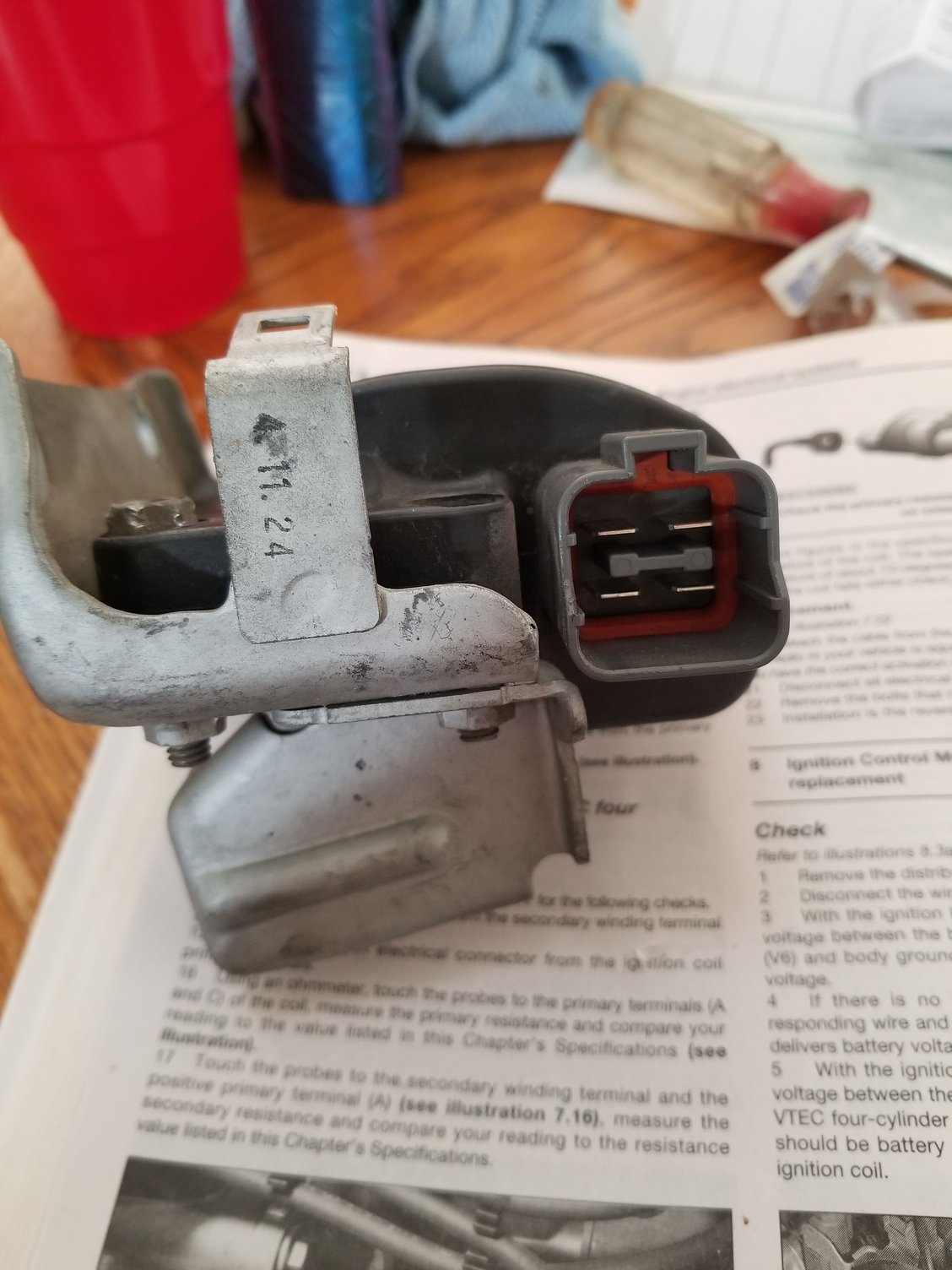

Here's a couple of pics of coil... and I bought a Haynes repair manual it says to test between A and C terminal but does not tell you proper ohms resistance? Is this right?
Yes you test between points A and C and the specs for the resistance are the ones I mentioned up above

The factory service manual also says to check the resistance between A and the coil output to the distributor. It should be 14-22 kOhms (14,000-22,000).
