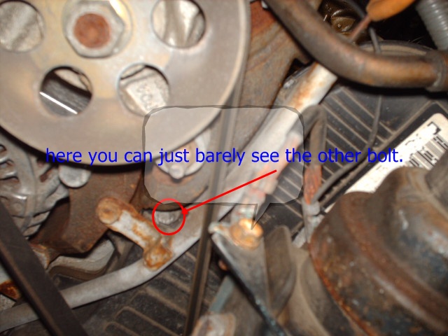

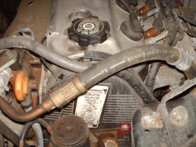

5. Now you will need to get the upper timing belt cover off, there are 2 bolts that hold it on. The first one is easy and is down by the motor mount. The second one is in a tricky spot. You will need to take out the bolt holding the dipstick tube on and pull the tube up until its bracket touches your power steering pump bracket and then take out the timing cover bolt.
6. Pull off your timing cover and then take a look in your drivers wheel well. Theres a star shaped hole in the plastic splash guard to access the bolt on the main engine pulley. get your 19mm socket and extension and breaker bar or ratchet and stick it in there onto the bolt. you will see on the timing belt pulley a stamping that says UP. Turn the engine counter clockwise (CCW, to the left) until this mark is pointing straight up and the two dashes line up with the surface of the head.

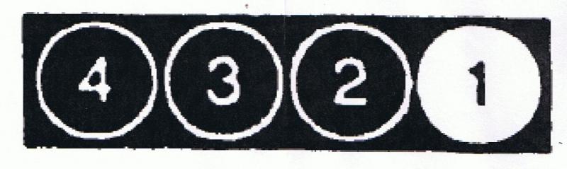

7. Break the lock nuts loose on all 4 rockers for cylinder number 1 and slide a .012 feeler gauge in between the rocker and valve on either exhaust rocker for cylinder 1 and adjust until theres a slight drag sliding it back and forth. Do this for both exhaust rockers and tighten the lock nuts. Snug them up with your 10mm wrench while you hold the screw from moving then re check the clearance to be sure. If using a torque wrench all the lock nuts will be torqued to 14 lb ft.
8. Do the same thing for the intake valves using a .010 feeler gauge and tighten lock nuts.
9. Turn the engine CCW until the UP mark points to the exhaust manifold and the dashes point up and down.
10. Set your valves on cylinder 3 just like you did on 1.
11. Turn the engine CCW until the UP mark points down. the dashes will line up with the head surface again.
12. Adjust cylinder number 4.
13. Turn the engine CCW until the UP mark lines up with the intake manifold and the dashes are straight up and down.
14. Adjust cylinder number 2.
