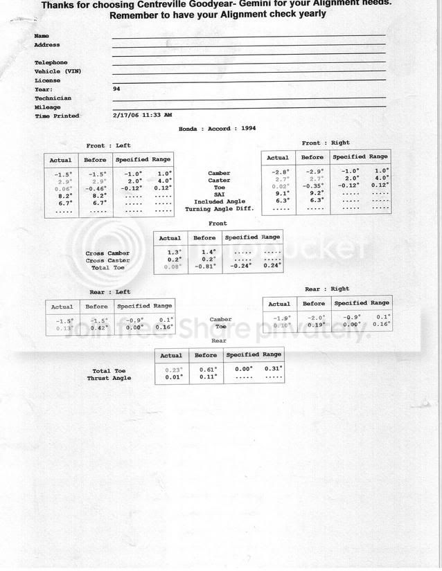

OOK i dropped my car about 2 inches last May with H&R sports and KYB AGXs. Now mine front tires are totally done becuase I procrastinated getting a camber kit or alignment for 9 months. I got my new tires on a few days ago and this morning i took my car to Goodyear to get an alignment. He told me he cant adjust the camber due to my modified suspension so he said he would do everything else. i said OK. I get my car back and now it still veers to the left if i let go of the wheel. On the paper he gave me it shows that he adjusted the toe. I called GOodyear and they said to bring it back and they could possibly charge me more.
Im just wondering if the camber is what could be making my car still go to the left? or what else it could be. or should they have made it go straight even though they didtn change the camber.
...and since they did adjust the toe, my tires should last me a lot longer shouldn't they even know my goes doesnt drive straight?

The three adjustment perameters in an alignment cause the following
Camber: The car will pull to the side with the greater positive camber value
Caster: The higher the caster angle, the greater the tendency to roll straight, and the the harder to steer off center
Toe: compensates for rolling / dynamic forces which normally try to rotate the wheels around an axis drawn thru the ball joints such that while rolling, the wheels point straight ahead or slightly inward.

Centreville Goodyear's spec sheet bears out what I said.
You've got camber readings of:
-1.5d on the Left Side
-2.8d on the Right Side
The left side has the higher (More positive) value
P

Camber is the angle of the wheel, measured in degrees, when viewed from the front of the vehicle. If the top of the wheel is leaning out from the center of the car, then the camber is positive ,if it's leaning in, then the camber is negative. If the camber is out of adjustment, it will cause tire wear on one side of the tire's tread. If the camber is too far negative, for instance, then the tire will wear on the inside of the tread.
Camber wear pattern
If the camber is different from side to side it can cause a pulling problem. The vehicle will pull to the side with the more positive camber. On many front-wheel-drive vehicles, camber is not adjustable. If the camber is out on these cars, it indicates that something is worn or bent, possibly from an accident and must be repaired or replaced.
try something..loosen up the rear cross member bolts ( 4... 17mm ) get a pry bar and pry the cross member left , , while holding the pry bar , tighten the bolts on the cross member ..

You know what, though? I think I'd go somewhere that people really know what they're doing, and make sure the height is what you meant for it to be.
I suggest that your height is not adjusted correctly. I don't understand why there would be such a huge difference in camber left/right unless one side is lower than the other.
Where to get an alignment: You need to go somewhere that people enjoy their jobs and are genuinely intersted in the enthusiast market and performance applications.
You might have to talk to people about what your purpose is in lowering the car so they know you're not a complete freaking ricer lunatic.
I get my cars aligned next to the state police station out here in Culpeper. When I first met the technician, he was on the way out to tell me that the camber was ridiculously out of kilter, and he was shocked to find a 50 year old track driver waiting fo rhim.
When I explained exactly why I wanted 2.5 degrees negative on the front and 1.5 degrees negative on the rear, and talked about how it was being driven, he understood and proceded to do the correct total toe and total overall thrust correctly, and with my application in mind.
When you start doing weird things like this, you can't just assume people will automatically go as far out of the way as they need to go to take care of you.
