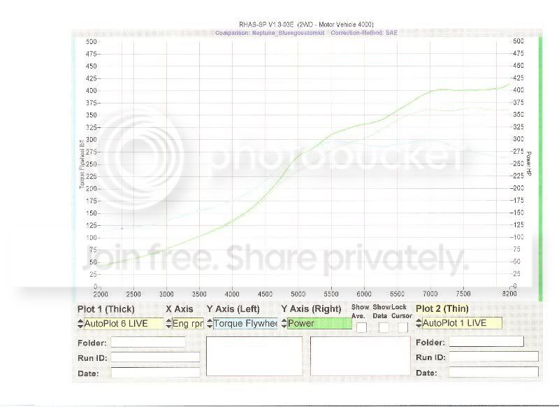

for the life of me i cant get rid of this little dip in my graph.
blue line is 12 psi, red line is 17 to 18 psi
before you say anything, there is boost creep, about 1 psi from around 17 to around 18 psi (even with the tial 44mm). either way i cant get the power to not hit a flat spot around 6500. i added over a degree of timing on the dyno and i didnt gain any tq and lost a tiny bit of hp so i took that back out( running between 13 and 15 degrees total in vtec at 18 psi with no signs of det. on the plugs). the afr in that area is low to mid 11s, and i dont wanna go leaner. what could be up?

my vtec is at 4700, however thats not my main concern. im talking about how the slope of the graph doesnt keep the same between like 6300 at 7000, then it picks back up. also, the torque looses like 10 or 15 ftlbs in there alsoMy charts with creep looked the exact same. The torque curve is on it's way to flattening out or heading south, then the boost creeps and it picks back up again, making what looks like a dip in torque
<TABLE WIDTH="90%" CELLSPACING=0 CELLPADDING=0 ALIGN=CENTER><TR><TD>Quote, originally posted by Hotredux &raquo;</TD></TR><TR><TD CLASS="quote">You just said it creeps 1psi. What makes you think that's not just the creep?.</TD></TR></TABLE>
the 1 or so psi that im creeping isnt going to cause my car to gain 75hp in a 1000 rpm range

just by looking at your graph you have boost creep more than just 1 psi. the dip u r talk n about in the 6300 rpms is mostl likely where boost settles out for a little bit then starts creeping some more.
Also you need to raise your vtec to get rid of the dip at 4700rpms. try increasing it to 4900

<TABLE WIDTH="90%" CELLSPACING=0 CELLPADDING=0 ALIGN=CENTER><TR><TD>Quote, originally posted by blackeg &raquo;</TD></TR><TR><TD CLASS="quote">the 1 or so psi that im creeping isnt going to cause my car to gain 75hp in a 1000 rpm range
First off, it's not picking up anywhere near 75hp from the recovery of that dip. I don't see where you're getting that from. Forget about the HP curve altogether and look at the torque curve because that's what matters and isn't RPM distorted.
It isn't picking up all the much torque (about 15-20ft/lbs) and on an efficient motor like that and a large turbo the amount it's picking up is completely realistic for 1-2psi of creep.
Maybe this will help a little. Notice, it isn't really picking up a massive amount of torque, and I even drew a best guess of where the torque would be headed without the creep.
<TABLE WIDTH="90%" CELLSPACING=0 CELLPADDING=0 ALIGN=CENTER><TR><TD>Quote, originally posted by boosted k20 &raquo;</TD></TR><TR><TD CLASS="quote"> the dip u r talk n about in the 6300 rpms is mostl likely where boost settles out for a little bit then starts creeping some more.</TD></TR></TABLE>
Exactly.

i know what you guys are saying about the tq. even though my table timing is about 13 degrees total in that area, the actual timing jumps from 20 to around 23 degrees right at 7k where the power jumps back up.

the torque is on the graphs, its the lower lines around 250-300.
i took the car to the track yesterday and based off the datalogs it was seeing 15.5 psi around 5500rpms and got up to 16.9 near redline

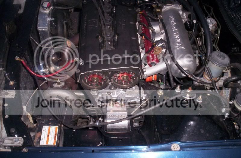

heres the best pic i currently have of it
