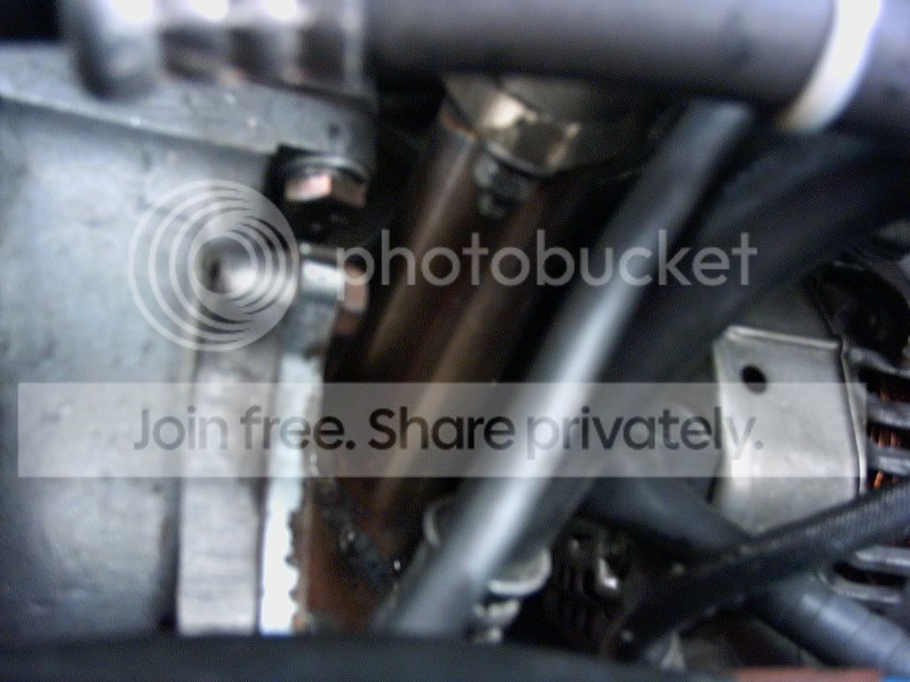

Is there a pic of the wastegate dump ? is it dumping near the compress inlet ?
its kind of hard to read those A/F readouts so be careful on your A/F ratio.

Is there a pic of the wastegate dump ? is it dumping near the compress inlet ?</TD></TR></TABLE>
yea trust me the original timing maps I was using didn't have that dip there, but I had switched to this one when we were trying to diagnose the problem because supposedely this was a tuned h22 map and i wanted to see if the car would still run like **** on it. I didn't notice that the timing maps I switched to had that irregular dip there. His afr's basically stay right between 11 and 12 so he should be fine in that department.
His wastegate isn't open dump. Its dumping back into the downpipe with a closed loop setup. This is probably causing a ton of turbulence in the exhaust flow because instead of dumping far down the downpipe it dumps in the bend coming directly off the turbo which i know has to be killing some power. Meltman said that he did try taking the wastegate off and turning it around so it was dumping into the air rather than the downpipe and after that the car would buck all over the place when he tried to get on it. I'm guessing maybe he gained a ton of power after changing that around and was leaning out. What do you guys think?

well if you opened the wastegate up and the car ran drastically different like you said then i'm willing to bet it was causing some kind of powerloss.
There really isn't any point in doing anymore tuning until we can figure out what is causing you to lose this power. Its obvious the dip at 5k rpms is caused by those dips in the timing maps that i didn't notice. If you want you can stop by my house and I can add the timing back in for you and change any afr changes in that rpm range, but other than that retuning isn't going to change anything because we know the rest of the powerband is pretty damn low as well. The power picks back up after that dip in the timing, but it still is making terrible power. I'm willing to bet that if its not something with the dumptube then something in your ignition is messed up. When your dad regapped your plugs did you notice that it was trying to cut out on you again like it was doing to us before? That could also cause huge losses in power, but it looks like you were at least able to rev it out all the way on the dyno. Either way i can tell that your car is not making near the amount of power that it should be for some reason.
