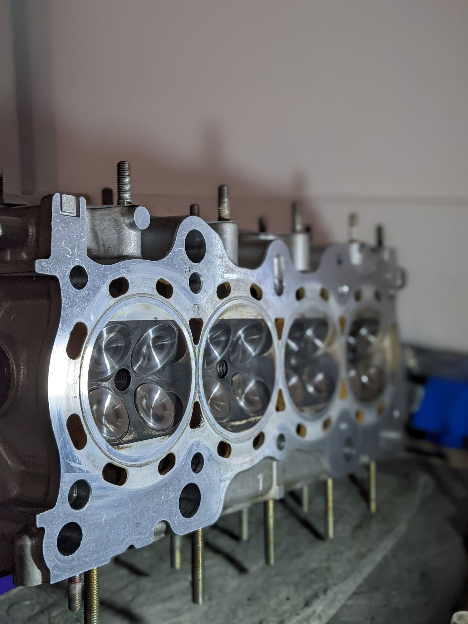

I have wondered ever since I built this engine what it is actually capable of. It seems like most built b-series are 600whp plus. I built and tuned the engine myself and made 400whp conservatively with little ignition timing on a mustang Dyno. I since then have turned it up at the track with a little more timing and a few pounds of boost. Here's my specs:
B18C1 CSS Block
Stock GSR Crank
81.5mm 9:1 Manley Pistons
Standard Wrist Pins
Skunk2 Alpha Rods
ACL Race Bearings
ACL Oil Pump
Stock Head Casting (No Port or Polish)
Ferrea 6000 Valves
Dual Valve Springs & Retainers (forgot brand)
GSR Cams
Blox Intake Manifold
Cast Log Turbo Manifold
GTX3076r 20psi
74% Ethanol Content
My dilemma is how determining much this engine can handle. My original tuner who helps me with data and tips on tuning says 500whp is my limit with these Skunk2 rods. He said if I want to go any higher I will need some stronger rods. These rod have been reused 3 times throughout my engine builds with this being the highest power they've seen. My goal with this engine was around 600whp. Are the rods really my bottleneck? What would you push through this engine? Btw this is a track car for road racing. It runs hard for 30 minutes at a time between low and high boost (10psi - 20psi).

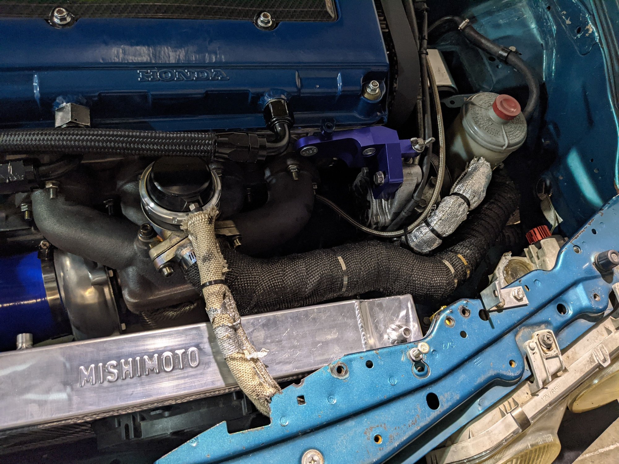

Not sure what your current fan/shroud setup is but if you got a tubular mini-ram or ramhorn style manifold that's designed to allow for AC fitment, and route your wastegate and downpipe down under the oil pan, that may open up more room for a fan with a bigger motor or a shroud.
The side exit is very cool but I don't think you're doing yourself any favors with that routing, the exhaust would be more out of the way from the radiator if you went down.

It's a bit tight in here which is why we went with the side exit. The turbo had to get rotated this direction to fit the full radiator. And the radiator is actually lower than factory and angled towards the front of the car to get enough space for the wastegate. I think the only way I'd fit a ramhorn is if I got one with a side mount wastegate. There wasn't even enough room for a fan or shroud so I had to do a push setup with a single Spal fan. This is with the turbo tucked tight against the block which required TONS of trimming to make that work with this compressor housing. It's an absolute pain to get to the turbo for anything. And the clutch slave cylinder is almost completely inaccessible which really sucks when we have to bleed it.

I'm not as familiar anymore with the Integra chassis when it comes to how their heat exchangers mount in the front. Something about your setup seems a bit off or like the radiator is further towards the engine than I'm used to seeing.
I'm probably just not remembering right though.
