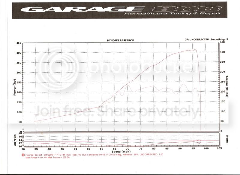

Default Re: What does it take to Rev 9500k + ? (boostedcivicsir)
yup, my peak of 435 on a b16 was at 9900, but thats where i let off, graph was still climbing, rev valvesprings and retainers, stock valves. t3/62-1 .83 ex

Default Re: What does it take to Rev 9500k + ? (Garage 808 Hatch)
<TABLE WIDTH="90%" CELLSPACING=0 CELLPADDING=0 ALIGN=CENTER><TR><TD>Quote, originally posted by Garage 808 Hatch &raquo;</TD></TR><TR><TD CLASS="quote">yup, my peak of 435 on a b16 was at 9900, but thats where i let off, graph was still climbing, rev valvesprings and retainers, stock valves. t3/62-1 .83 ex </TD></TR></TABLE>
The only way it made power till 9900 was because you had massive boost creep, I'd like to see the dyno graph of that.

Old Jan 11, 2007 | 04:12 PM
Garage 808 Hatch's Avatar
Posts: 5,433
From: CRESWELL, Oregon, 97426
Default Re: What does it take to Rev 9500k + ? (dturbocivic)
sorry its in mph, the rpm pickup skips on my car.
this is 3rd gear on stock sized tires.
and its not myh best pull,just the one i have scanned
