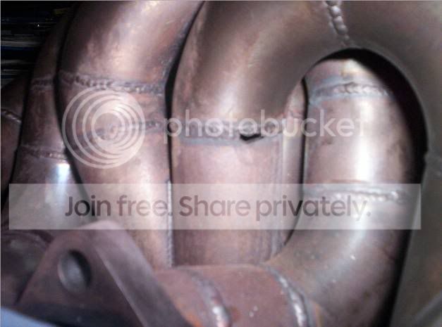

compressor side is fine.... **** i was mising a chuck of a weld in my manifold that may have done that. ONE FAB once again in some way or another screwing me. is this bad? is my turbo ruined? i didnt think it went in cuz my turbo spooled fine.
heres a pic of the chunk missing

sorry to hear. the welds on that manifold look COLD and ******* terrible in general

manifold isnt my problem its been taking care of and replaced right now my turbo is the issue

I think your fine. I would run the turbo, doesnt look like there is enough damage to throw the balance off to the degree where it would explode at high boost. That lil piece missing from your manifold is definitely what did it. As long as the exhuast housing isnt getting scarred by the wheel and there isnt excessive play i would say your golden.
