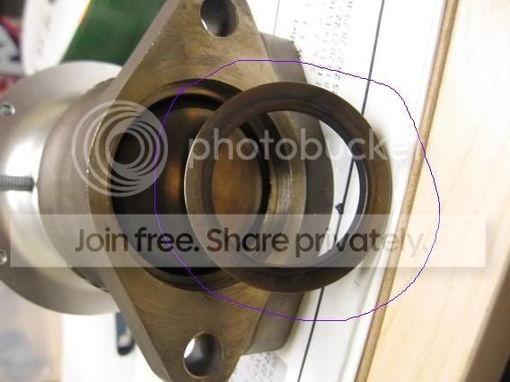

just got my wastegate. i tried to blow on the dumptube and air goes thru, i can see that the valve isnt closed all the way or in other words the wastegate is open just a little, is this normal? pls help me....

What kind of wastegate it it? If it's a TiAL, did you put the firering in?

valve seat missing

do you have pictures of what im missing?

ok i forgot to install the valve seat.thanks

Default Re: wastegate leaking? (4dek)

ok i already intalled that and dont have anymore leaks but my turbo still isnt spooling (cant hear it) even my blowoff valve dont open
