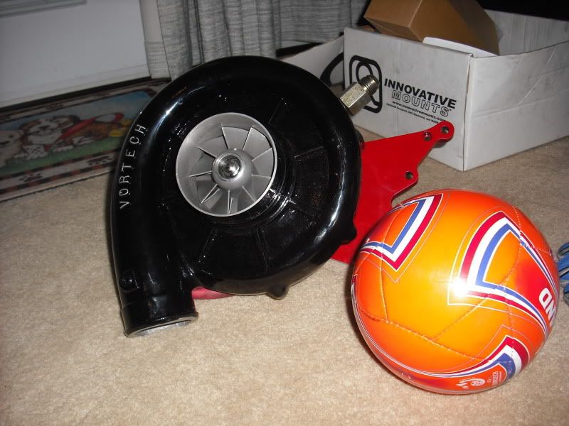

Ill try to answer all the questions, thanks for the compliments, much appreciated
-Most items were powdercoated however some items were painted gloss black as some items like the exhaust side of the supercharger could not be removed for powdercoat without replacing seals and such, so some items were painted to match

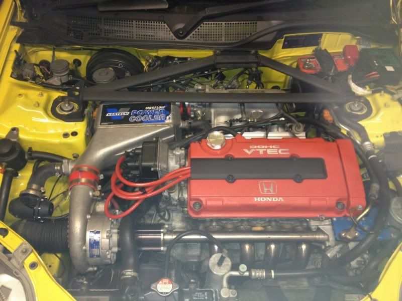

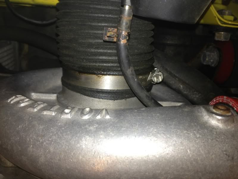

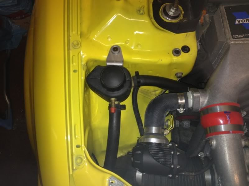

Here is my engine. Can you tell me on second pic how to change the coolent in that black reservoir and also what is the connection for with the red cap on it?
In 3rd pic exceive oil coming out how come solution?
I'm thinking to put a boost gauge in my car but where is the best place to put the boost sensor?

Where is your water pump mounted? How is it wired? Wired by switch to turn on/off or wired to run when the car is primed etc?
I would just turn the water pump on, disconnect 1 hose from the reservoir or the easiest spot to remove it and drain as needed...the pump will push the water/coolant out of the system & you can refill as necessary.
Honestly I am not sure what that spot w/red cap is for. Mine did not have that port & I did not use the black reservoir....I used a 5 gallon water cell in my trunk.
As for the boost gauge, you"ll just need to T/tap it into a vacuum line.
Engine bay looks good! Any dyno graphs yet?

Justin some differences in my set up do you know what that conection for on my second photo.
I can see on your picture that near your charger is a red hose connected to it.
I have hole but mines is locked off , any reason for that?

The red hose on the charger is part of the oil line set up that came with te kit... I got the bra from a friend of mine that just had it laying around. It was brand new and offered to sale it for $100 but then told me I could have it of he used my camera for the weekend, so I got the bra for free
Likely an overflow port, I assume that is your expansion tank?
